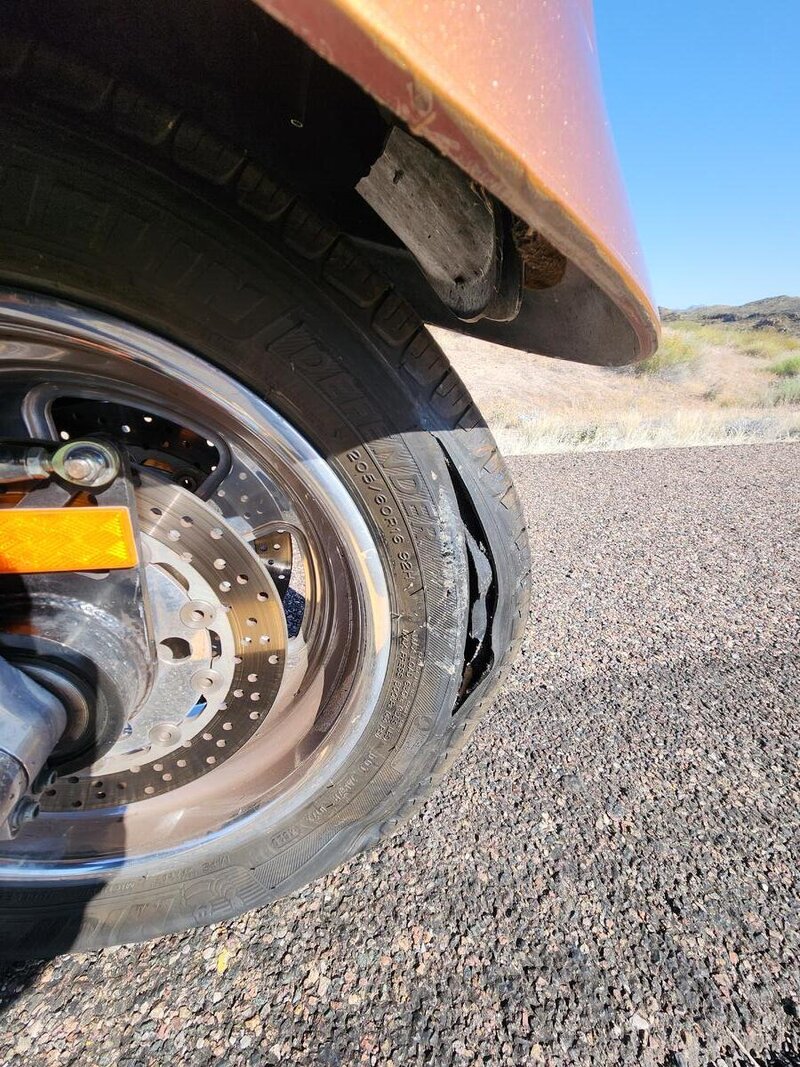

The disasters keep coming, and I'm leaving on a 2300 trip soon. Michelin Defender, 3 years old with 13000 miles on it. Stallion started shaking and this happened coming down from 70mph. I was at about 45mph when it went. I run the front tire with 40lbs in it. I just checked the tire pressure monitor that I have on the Stallion when it started shaking and it was at 40lbs. I just love taking the front wheel off. :mad: Rick

Last time i saw that was on a trailer that was outside exposed to the sun ..
That sucks but glad your ok.
