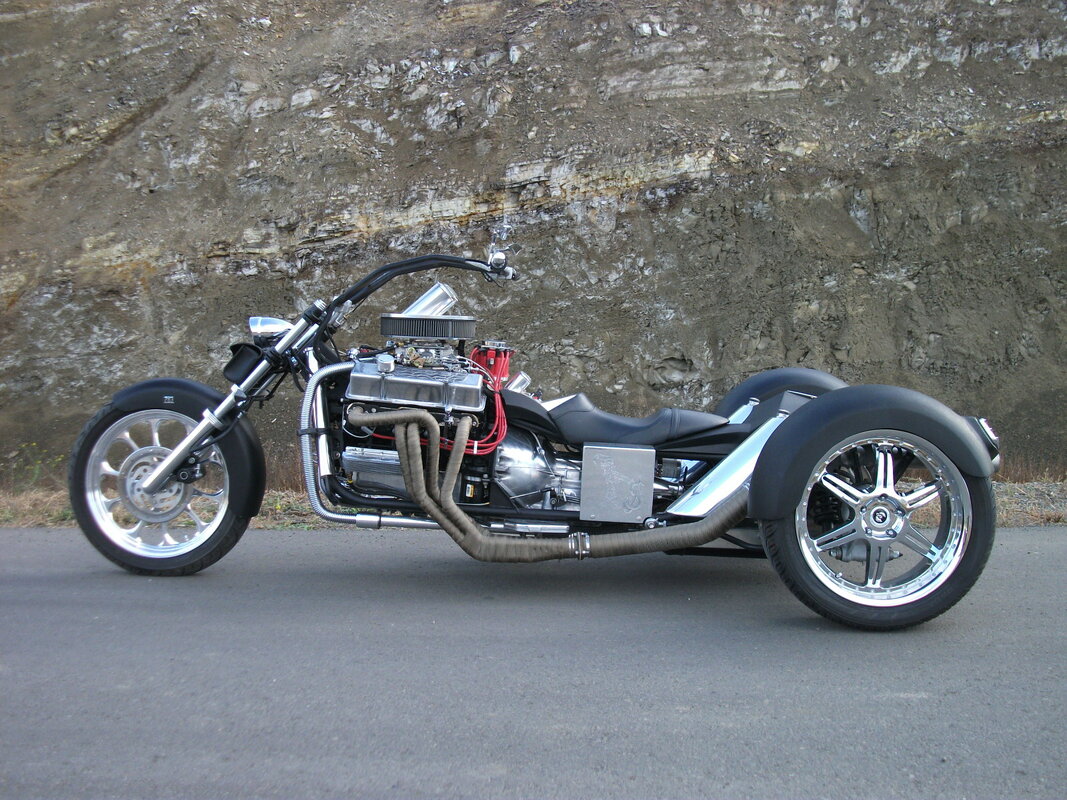

Here is a pic of the one I built a couple of years ago I started with an sub-frame assy out of an 97 Mark VIII Independent susp set up I'm using the front end off a 83 1100 wing with the heaviest springs Racetech had and with 40PSI in the front shocks it rides well. It does had a little body roll however it does ride 100% better than I ever expected. My biggest problem is when you get above 20-30 MPH the steering get pretty stiff which I guess is really a good thing.
