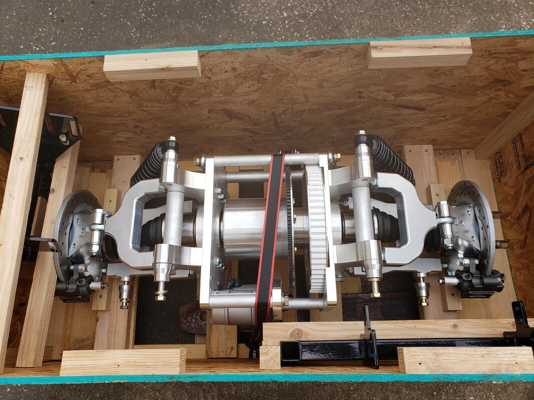

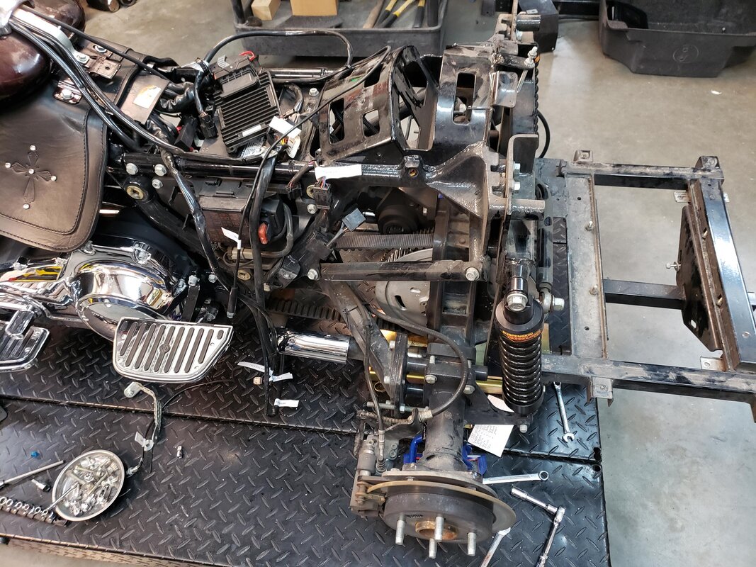

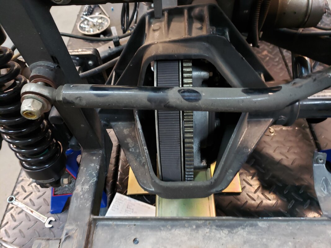

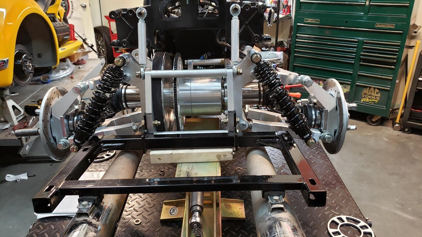

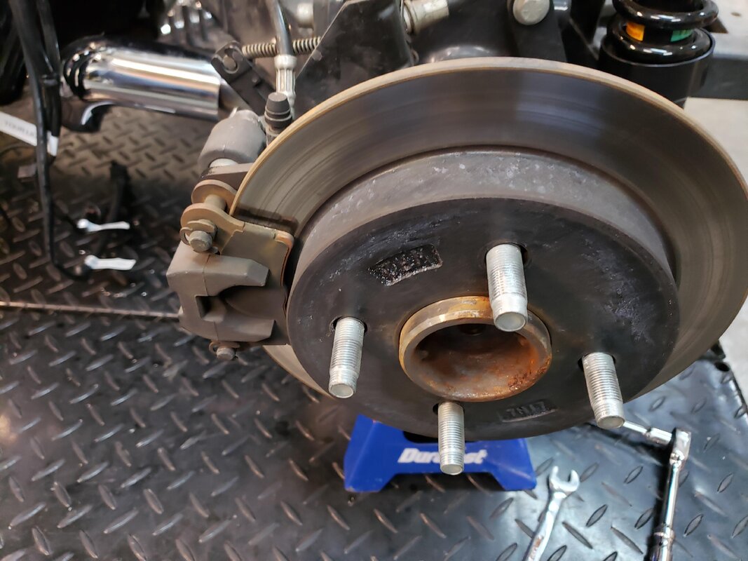

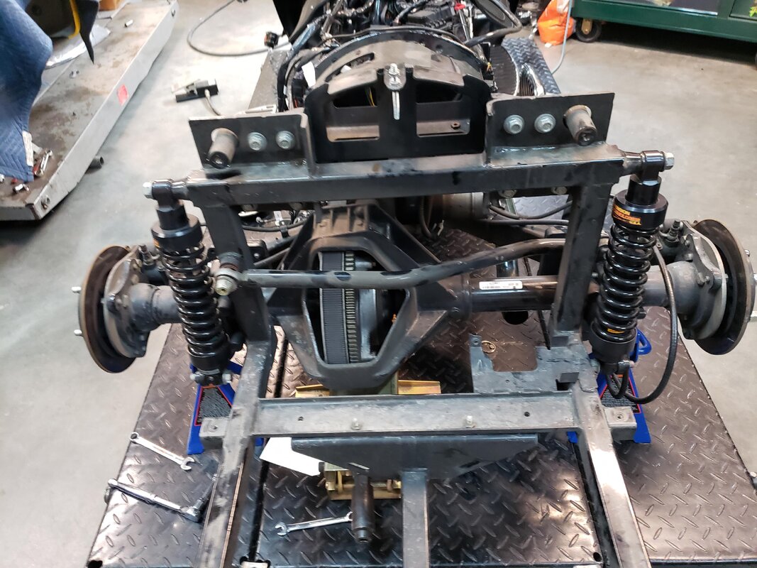

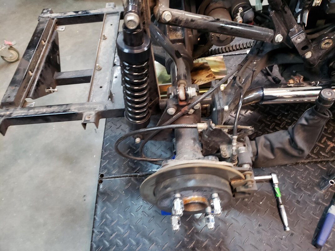

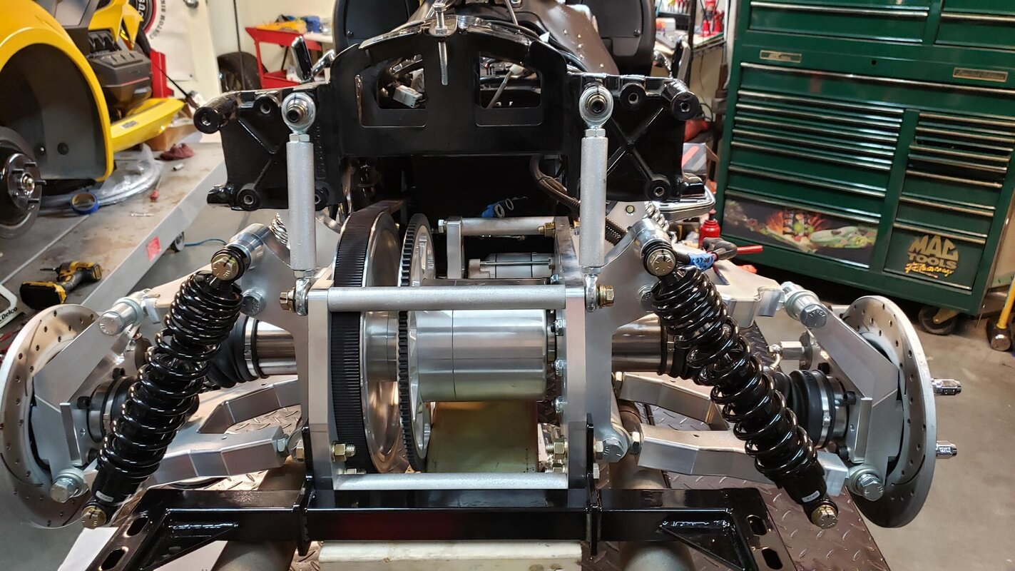

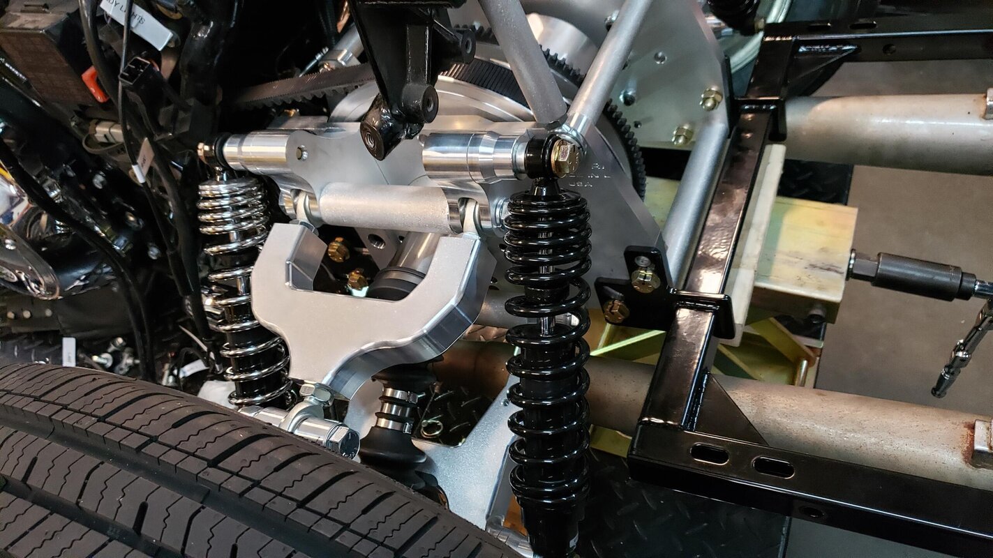

Jim, after talking to several IMC customers, we became a dealer for them and have converted one TG with the IMC and about to do our second one. The design and workmanship is 100% top shelf. Very happy with the company and its owner and the product. I have a local customer you can call and get some honest feedback from and another local guy who saw the first one and was so impressed he had me order one for his bike. Shoot me a PM if you want to talk to me or either of them. I can post up some before, during and after pics here too if you want.
He had installed upgrade shocks to try and get a more comfortable ride but was still unhappy with the solid axle ride. This fellow had done his research on IMC and came to us looking to have us order a kit and install it on his wife's TriGlide (pictured). This was our first install about a month ago.
