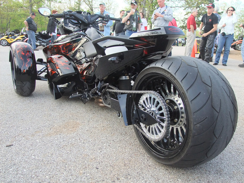

Only reason I can think of is looks. The owner of the custom Spyder below put motorcycle tires on his Spyder just to achieve a certain look. As you can see by that rear tire wear pattern there is an awful lot of wasted rubber on that monster tire.
