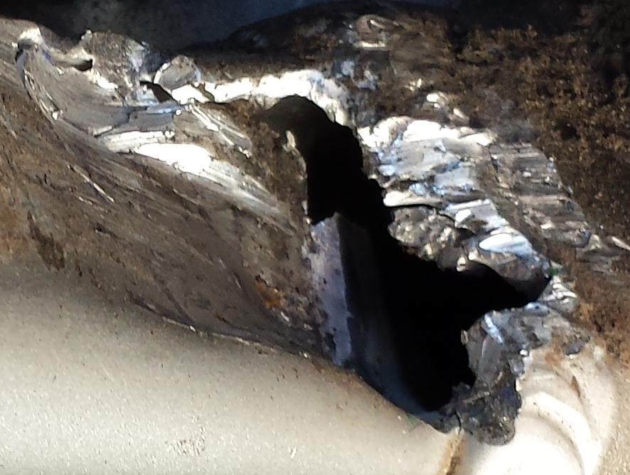

The yoke came off the driveshaft while riding down the interstate and nearly broke the bike's frame crossmember completely free from the weld and bent the transmission output shaft.
Fortunately, with the nearly broken frame, we were able to survive. An $8700 repair to replace the frame (frame is $5300 alone) and output shaft caused by their unsafe kit that they refuse to stand by. Beware MotorTrike. Purchase at your own risk of life.

I should pick up my trike later this week. I will post a picture of the frame damage caused later. At least my daughter and I weren't injured or worse. Not everyone has been so lucky. As for being safe or unsafe, fixing a problem after the fact doesn't make it safe until AFTER the fix. With the damage made, shipping the trike to MT and letting them weld the frame would NOT have been a proper or safe repair.

Pic of damage.
How do I get a pic of the frame damage to post? Current design may be great but MT knowing of the safety issue that exists for hundreds if not thousands of riders and not recalling is NOT a safety minded business. I may be wrong but I think the safety strap came about after a failure threw someone into a concrete barricade. I would have to read the lawsuit again. I believe there were big bucks paid out on that one. While not as bad as the Ford issue with rear end crashes causing fires, it is a safety issue that MT has to fix. At minimum, if you have a MT that does not have green yoke, park it and get replaced.
