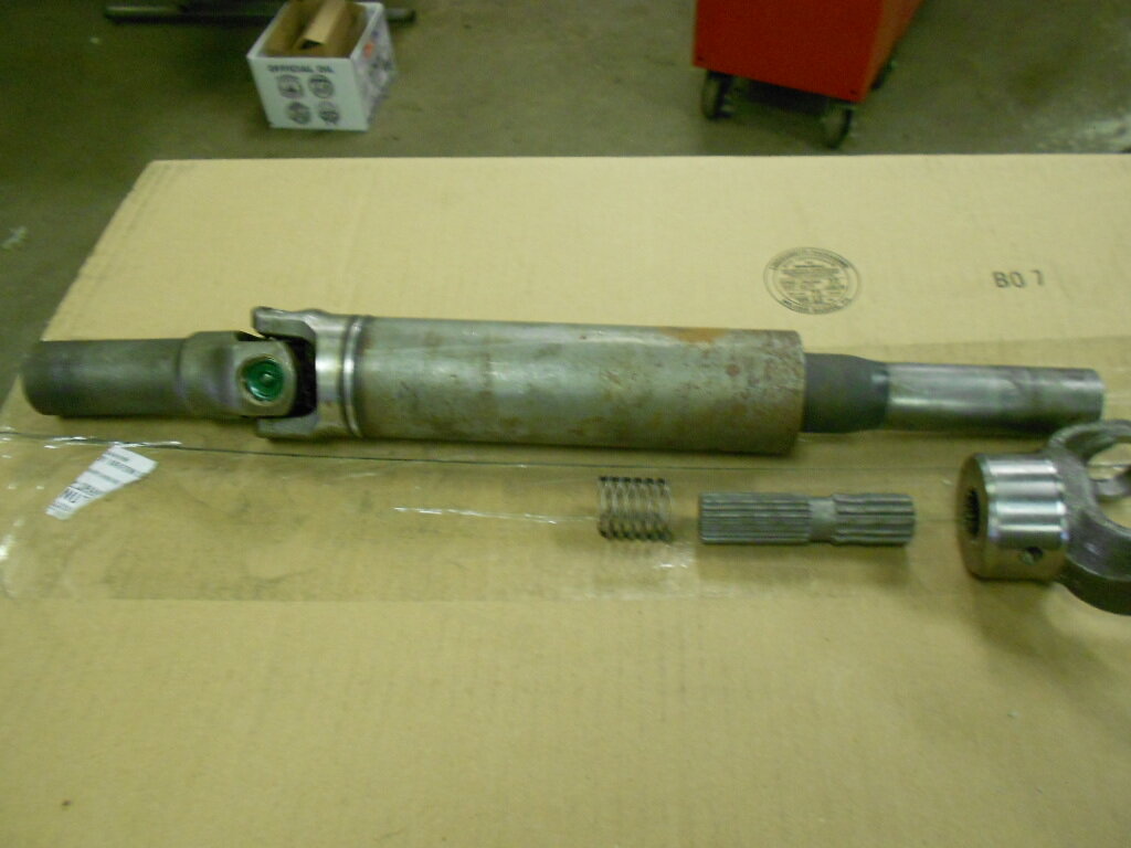

If the shaft can be easily removed, the front u-joint should be inspected too. Like the rear, it should have absolutely no play in the joint. Often, since the front u-joint is smaller one of the 2, its the one that goes bad. Also, if your shaft has splined sleeve, clean, inspect, and lube it also.
Here's an example of one with to much movement.
