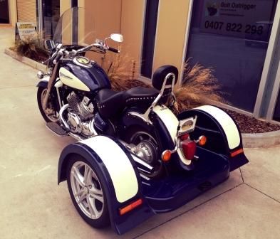

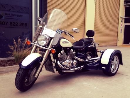

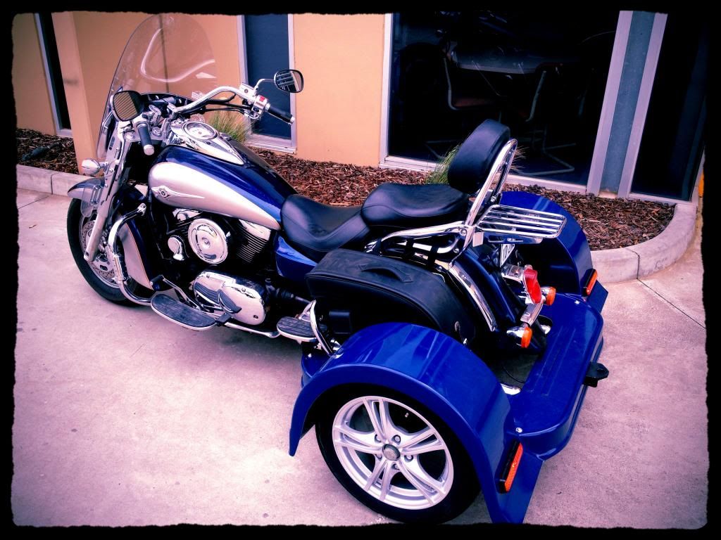

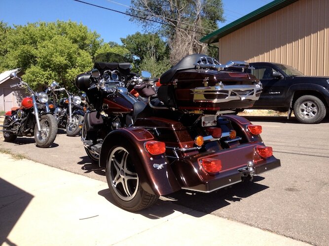

Here are two bikes l am working on, have just finished the Yamaha Royal Star and the Kawasaki Vulcan is being painted up at the moment.
not happy with gelcoat colour so body is in for paint at the moment, hoping to have back on monday.
Re: Outrigger Trike Pics
Thanks Dan, took me twelve months to get the Vulcan right, originally
Had 13 x5 tyres, too much body roll and after talking to another tike builder upgraded to the larger wheels. Big difference.
Built a steel body and guards then aliminium body and guards before finally going for fiberglass.
The Yamaha took two weeks to turn around, both the customer and myself are over the moon with the end result.:D

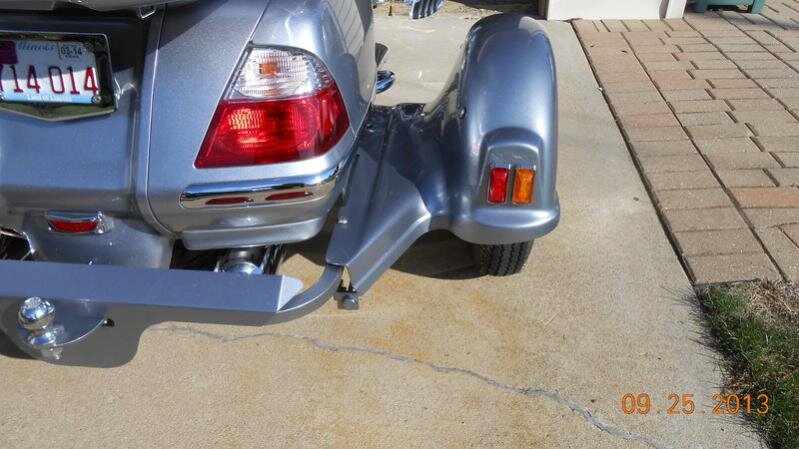

How are you going to fit it DanB? Fit to the bike or mounted to the outrigger?
Not sure I understand good buddy? My caption: New rear end, was a bit of a joke and didn't really mean a new differential on my Wing. I was just showing off the new look of the ass end of the bike.;)

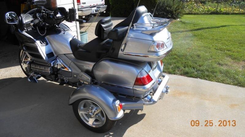

was referring to the goldwing boxes.
Duh? I must be getting old and retarded. The GW boxes (saddlebags) are mounted to bike. BTW, checked mileage today. As a 2 wheeler I average 36 mpg and with Tow Pac; 34. I'll take that. :Excited:
Rode my Wing this weekend for 500 miles with a group of riders down in the Texas Hillcountry. The lead guy rode a GL 1800 Motortrike and who is a spirited rider and had no problem keeping up with him. I now have nearly 1000 miles on my Tow Pac.
