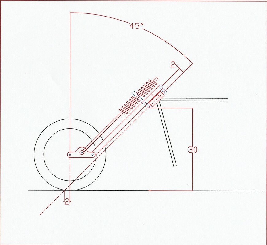

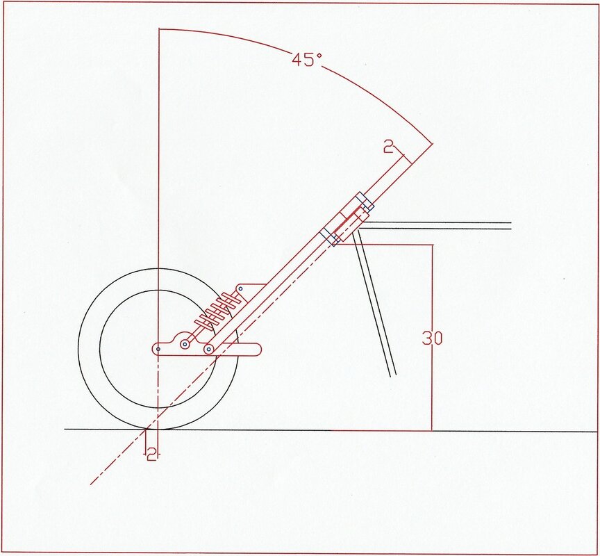

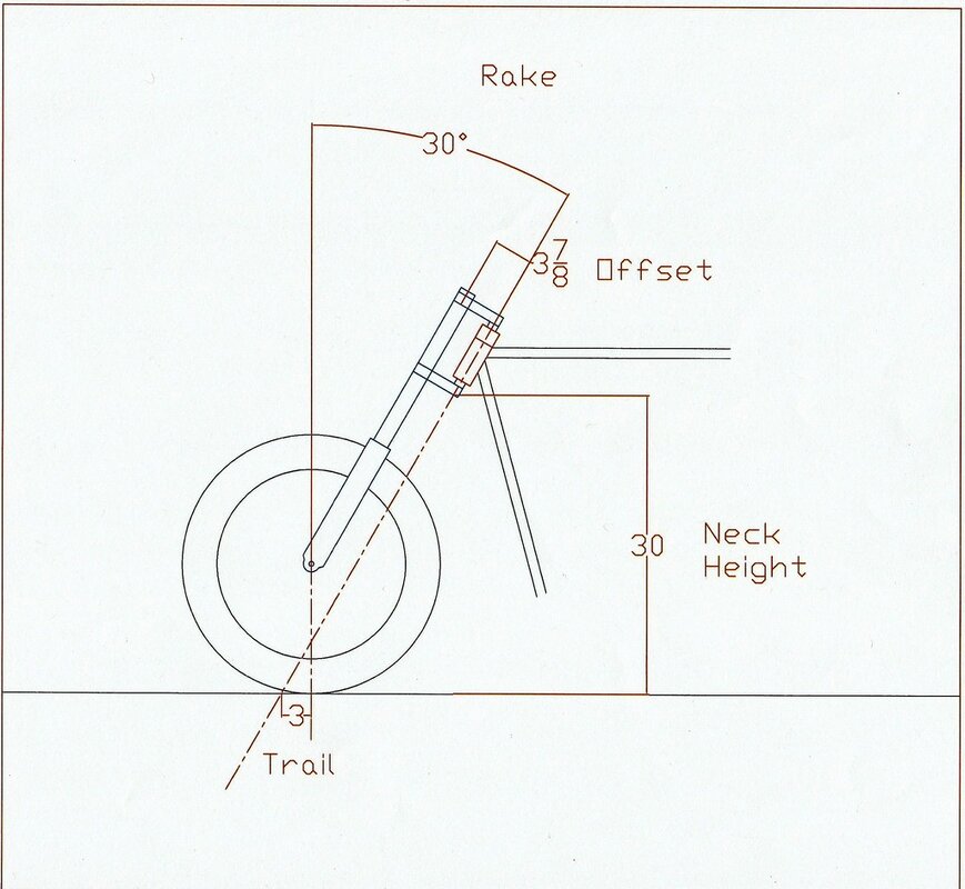

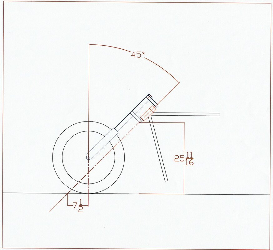

Put the rake on it however you like or want.
I dont like long rake and the long front ends that go with them. My personal choice based on how I want mine to perform. I am more of a middle of the road, I want the looks of rake but I want to keep it bit more quick handling but not a crotch rocket personal choice, make your personal choice based on what matters to you.
Then.....
Make the trail fit.

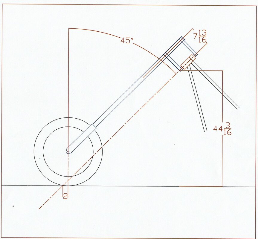

You have the angle you just have chosen.
As the diagram above shows, get the relationship of the neck angle to the front axle.
Now you know where the front axle must be.
Next is picking a front end that fits those dimensions.
