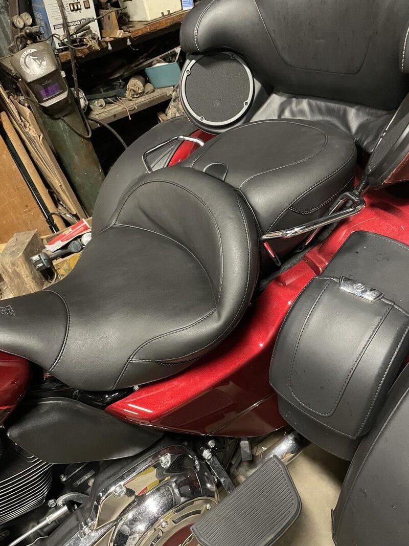

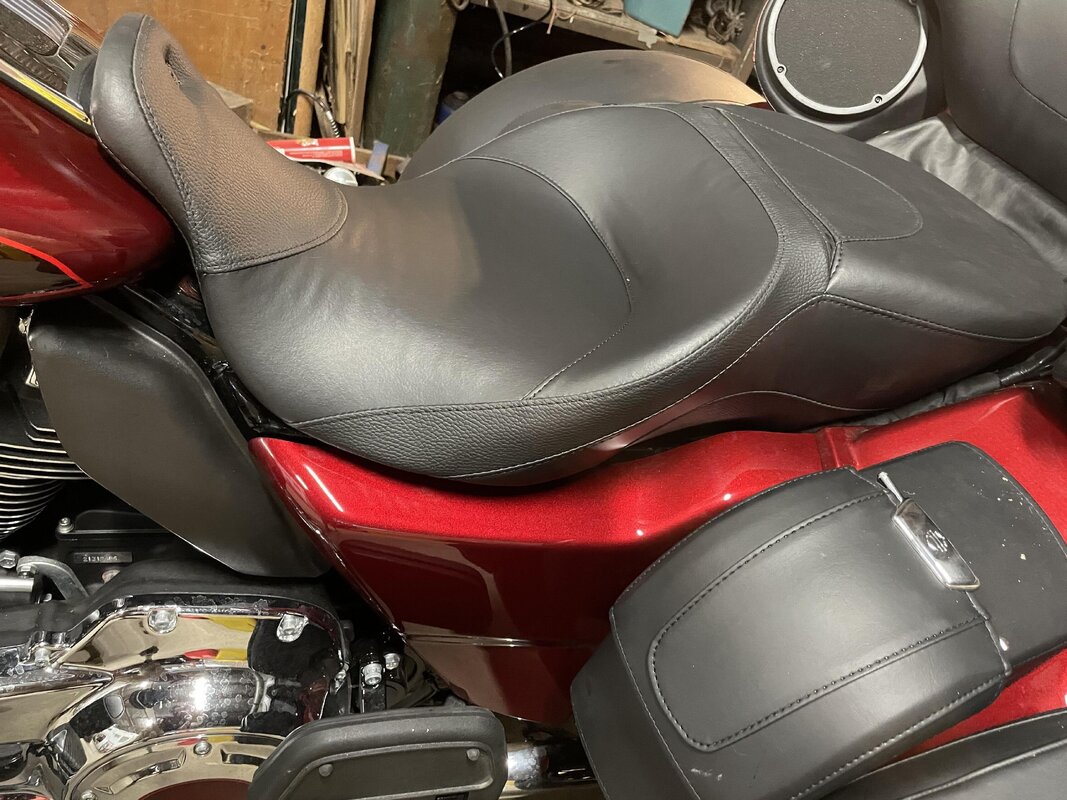

The Mustang extended reach seat fitted straight on with grab rails

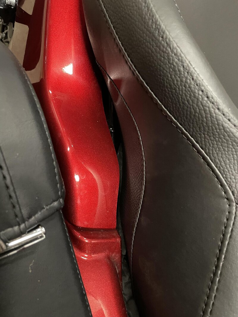

still got a lil bit of gap but seat mounts solid and comfortable. Pillion is much happier also and claims more comfort over the stock seat for her.
Coupled with the Kuryakyn Extended Brake Pedal has given me a safe operating angle for my rear brake lever (my knee doesn't bent far enough for stock setup)

I have been running a Road King reach seat on all my Freewheelers since new, My local dealer has a demo loaner seat program, it works good even though the HD parts book says it will not fit, it does, but there is a small gap on both sides at the side covers
