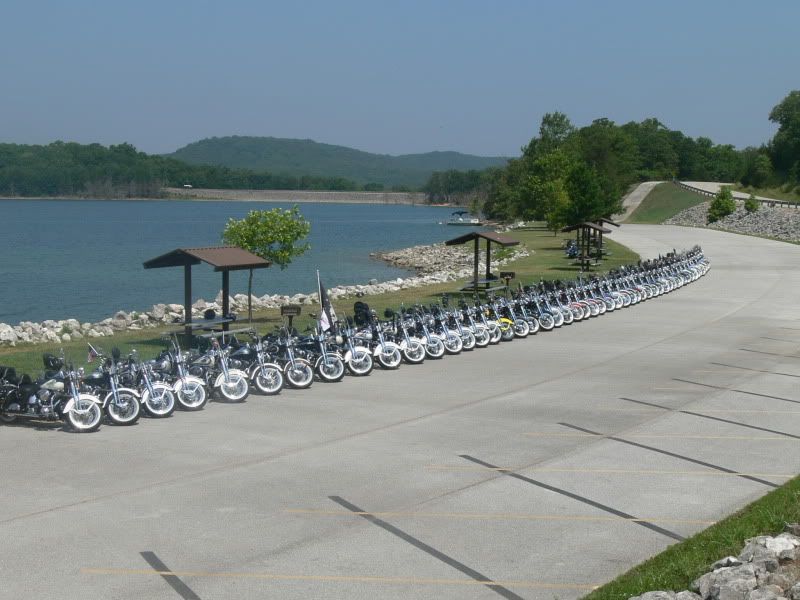

Here is what 56 springers in one place at one time looks like.
This was taken a few weeks ago at our summer rally held in ES Ar.
Great riddiing and we had a super host hotel.
They led rides every day, cooked each evening, and partied with us each night.
