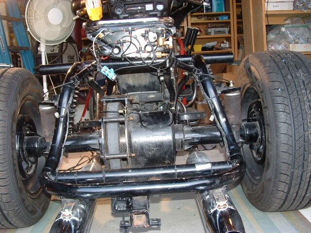

Where are good points to place jackstands? This is a Motortrike, looks to be a Gladiator, stamped 2006 solid axle, on 2006 Electra Glide Classic. Just don't know the best place for jackstands and don't want to mess anything up under there.
With a solid axle you should have the Trog conversion. The kit on my '02 was originally on an '06. You should be able to block up the rear of the frame inside of the mufflers. The body is mounted with 1/4" bolts through the frame. Be careful not to put the blocks under these bolts. They're not going to handle the weight without bending. Also make sure you don't pinch any of the wiring.
