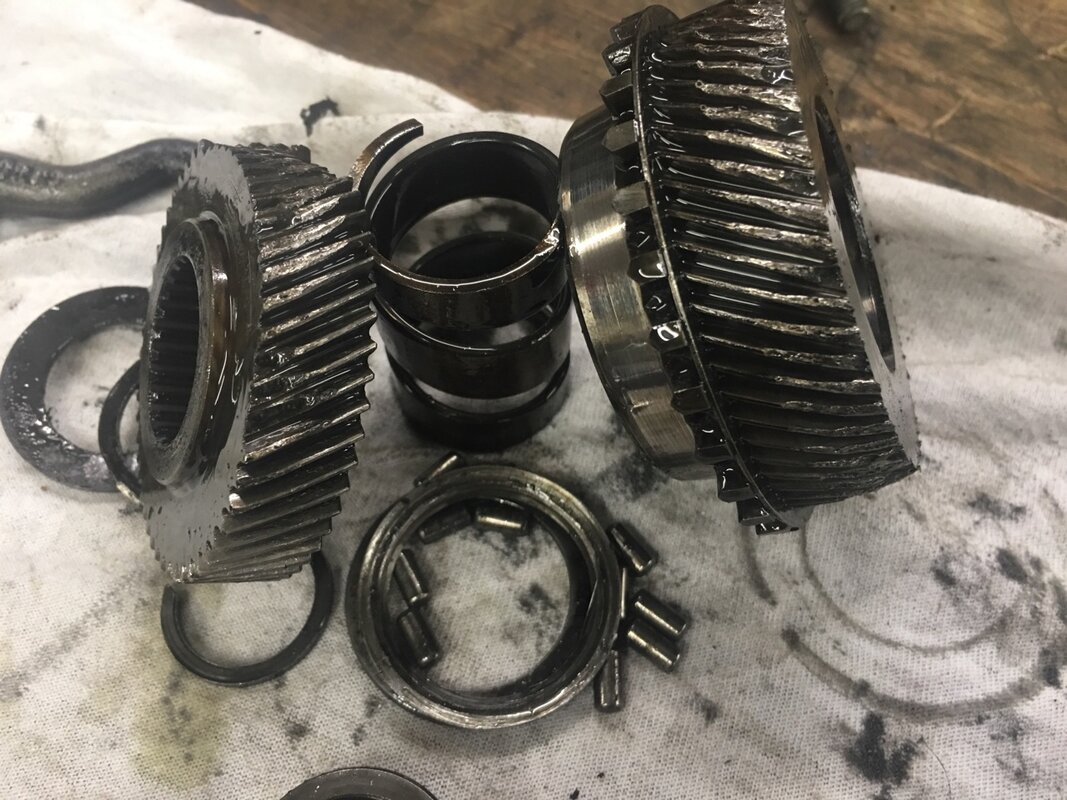

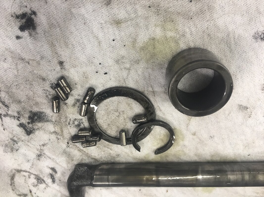

The builder opened up my core this afternoon, and man what a mess. He said the bearing under the nose cone blew up, letting the gear stacks flop around. He added 4th was the last one on the stack, so it caught the brunt of the damage. I'll try to add the pics...
Like I told him, good thing I was only about a mile from home when it let go.

That was a fairly late model box that died there. That is a spline shaft clip style.
In all honesty, I don't know a lot about 'em. This one was an "AH" single plate box. The builder I got the replacement from said he'd seen this happen before, but it's a rare occurrence. With the exception of an annoying nose cone seal leak, I got 5 years of trouble-free service out of it before it went hand grenade on me. Not bad, I thought, as I bought it pretty reasonable at the time. Too bad the rebuilt "AJ" wasn't as cheap! :D
