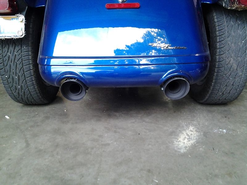

D&D 3 1/2" Touring Mufflers With Short Rounded Billet End Caps
The D&D Exhaust 3 1/2" Touring Mufflers with the short rounded Billet end caps and the 2" Vortex baffles (a D&D specific design) work great and sound awesome, deep and throaty but not obnoxious. They also give good ground clearance compared to the bigger 4" round muffler bodys and they fit the body cut outs nicely.ThumbUp Also the 2" baffles maintain low and mid torque better than the bigger around baffles out there like the 2 1/2" and bigger.
My Freewheeler runs great and sounds great with these mufflers. They are a little pricy but very well made.
Ride Safe,:)
Bill G
