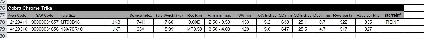

email from Avon
Got a reply this morning.
Motorcycle Technical <motorcycletechnical@coopertire.com>
3:59 AM (4 hours ago)
Hi,
Thank you for the below email.
We produce a MT90B16 Cobra Chrome Trike tyre. Our Cobra Chrome range has replaced the Cobra range.
Many thanks,
Avon Motorcycle Technical
As yet I have not seen a 16. On their site it only shows an 18. They did not tell me how long ago it was discontinued...Thanks Lee for your response, but is about $35 over JP. They are $128 & free ship. I will continue trying to find the new in a 16"

Was it a 16" ?? I am now going to wait a bit For the NEW & IMPROVED tire. No sense buying a discontinued tire when the new are a bit wider footprint, better wet handling & stopping ..Several now have the 18" & talked to another dealer that can get a 16 within several days.

Unfortunately it looks like even the new Chrome trike tire will only be offered in the basic Goldwing tire size. I've gotta say, I'm not too terribly surprised that they stopped offering their trike tire in the 16" HD tire size. The large majority of their tire sales in the trike industry are to the Goldwing base by a good margin.
You must not read everything. Post above yours states, they gave me a # for the 16" & a dealer already confirmed he can have it in 3-5 days........
I did see your post in regards to them being able to get one, that is why I took the time to comment & post a reply.
I would verify that they are ordering the TRIKE version. There is an Avon Chrome product line for 2 wheelers that are available in multiple sizes also.
This was a common point of confusion when the AV71 Trike tire was released also because they had a standard AV71 series tire & then the Trike version which were completely different tires.
According to Avon Tyres & my contact within Avon they are not producing a 16" trike tire in the Chrome product line.
My info came from the Co. in England where they are made.

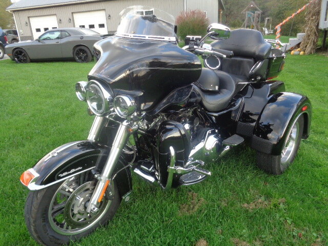

Is anyone running the Michelin commander 11 rear tire on the front of there trike back wards?
Yes I am on our Triglide and I think it is a great fit handles well wet or dry I have about 8,000 miles on it 9/32" start and still lots of tread 7/32" tread left so I'm on track 28 to 30,000 miles possibly more we shall see.:good: Ride safe Fred
