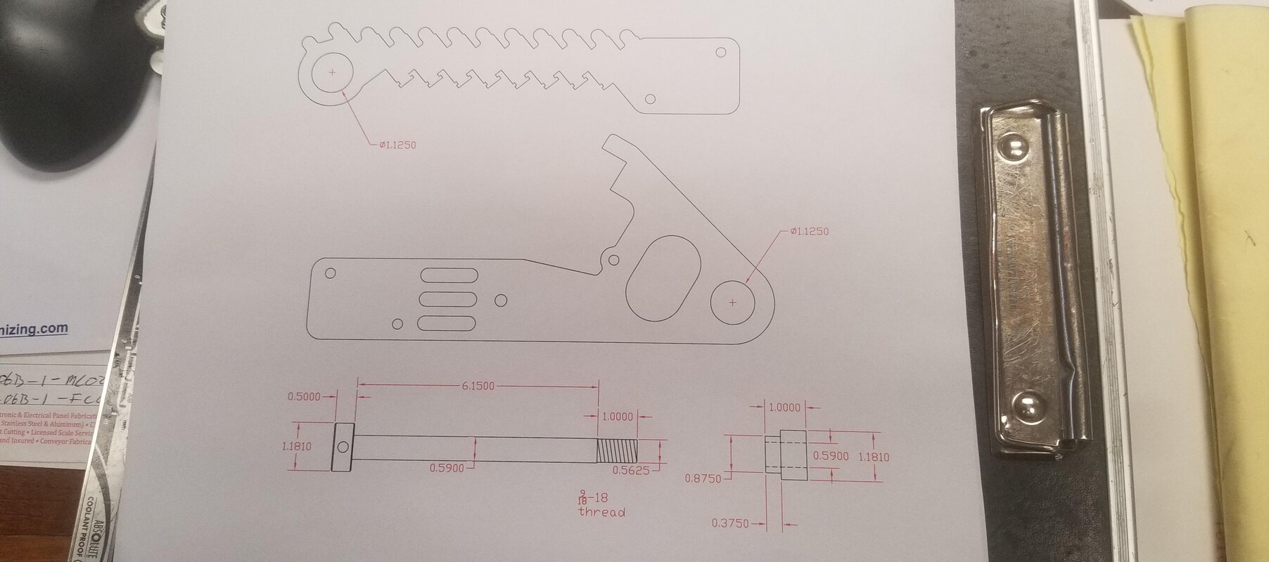

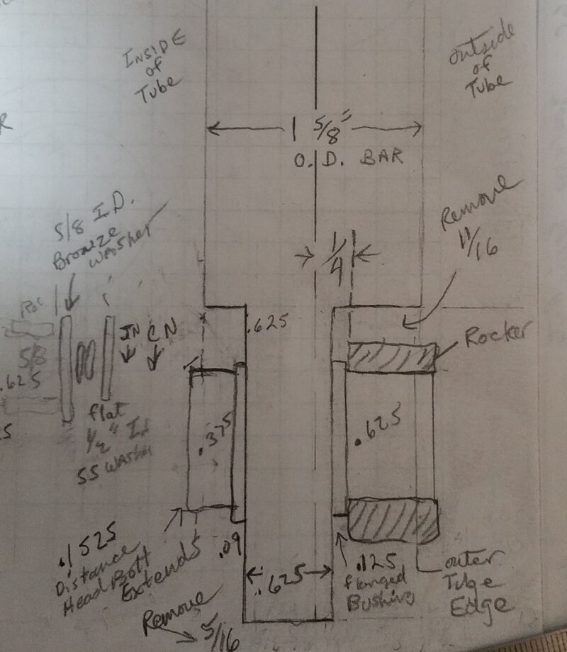

get a head of myself I thought I would post a pic and see what is said.
The drawing is not perfect all the way, but it is the basic set up I came up with.
I cannot have 3/8" of head bolt sticking out that far because of the disc brake rotor. So if I remove 5/16 off the inside edge, well it leaves just over an 1/8th of inch of head bolt sticking out past the down tubes inner edge.
I also need more axle space for the caliper support arm and the rockers have to be on the outside edge of the fork tubes center line to accomplish this.

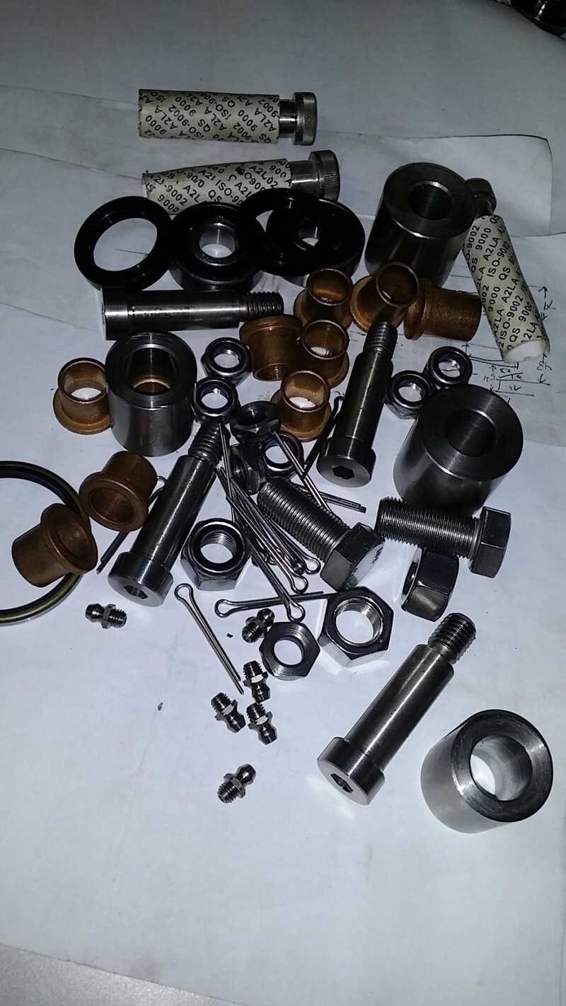

I end the shoulder bolt with a bronze washer (1/16th" thick) for the shoulder bolt, jam nut followed with the cap nut. Maybe a few shims if needed.
I can not find low profile bolt heads in 5/8" dia., half inch dia. has more choices, but I want to use 5/8" dia.
It does look like you are getting everything accounted for.
Leave enough room for a brake stay.
I also used 5/8 shoulder bolts. As I am rough on mine I tried to make the pivot stronger. But the eye design you are using is the most common out there and mine is the odd ball.

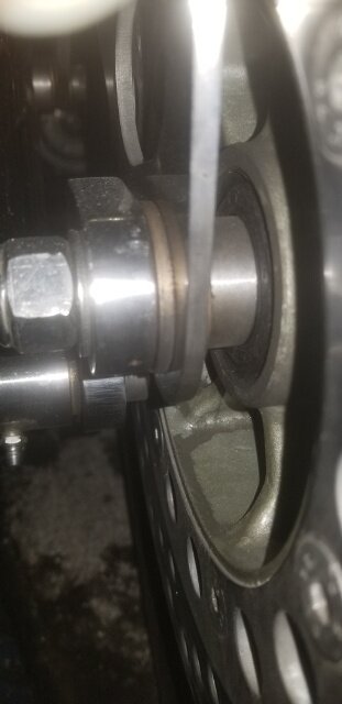

I didn't see much detail on the brake reaction rod, or it's fastening to the fork leg......mine could stand a rework, and Andy needs to build his.
Rex could you show this area more clearly?

From there it is just shoulder bolts and bushings.
The fork legs are simply drilled and tapped.
I will look for pics.

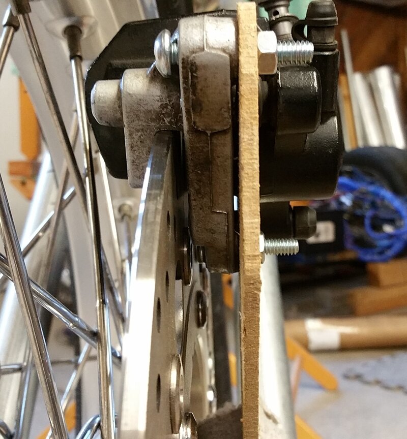

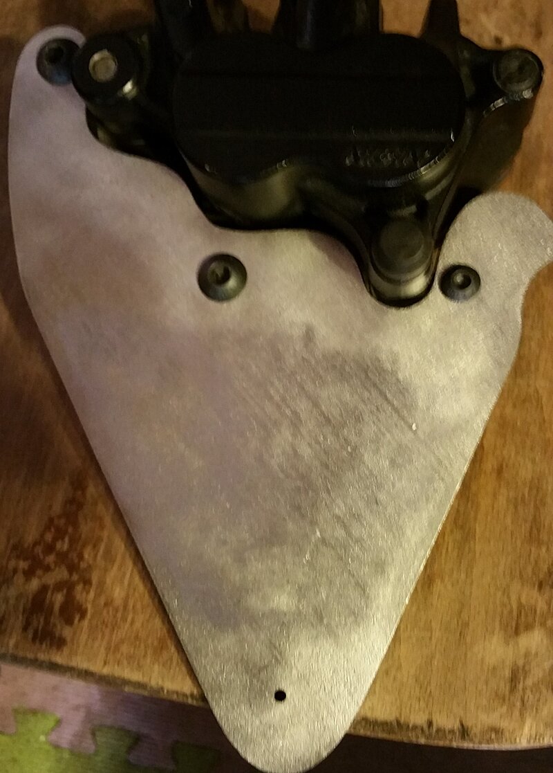

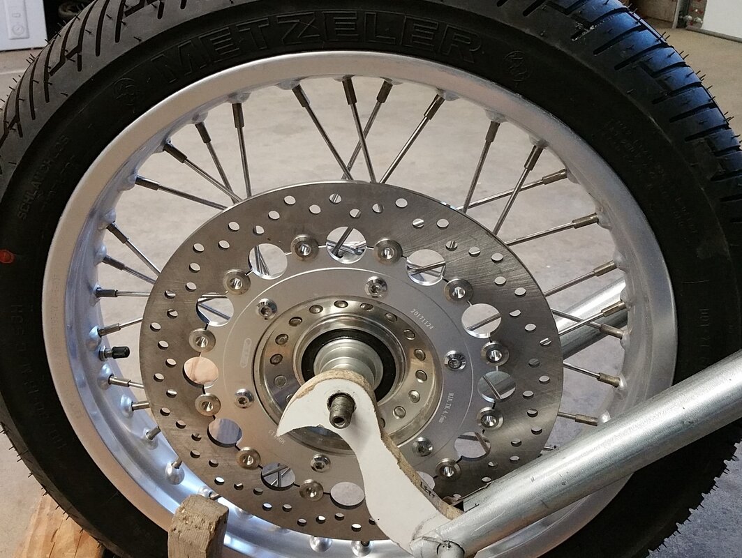

This is what I got down for the caliper support and the piece of 304SS I will use for it.

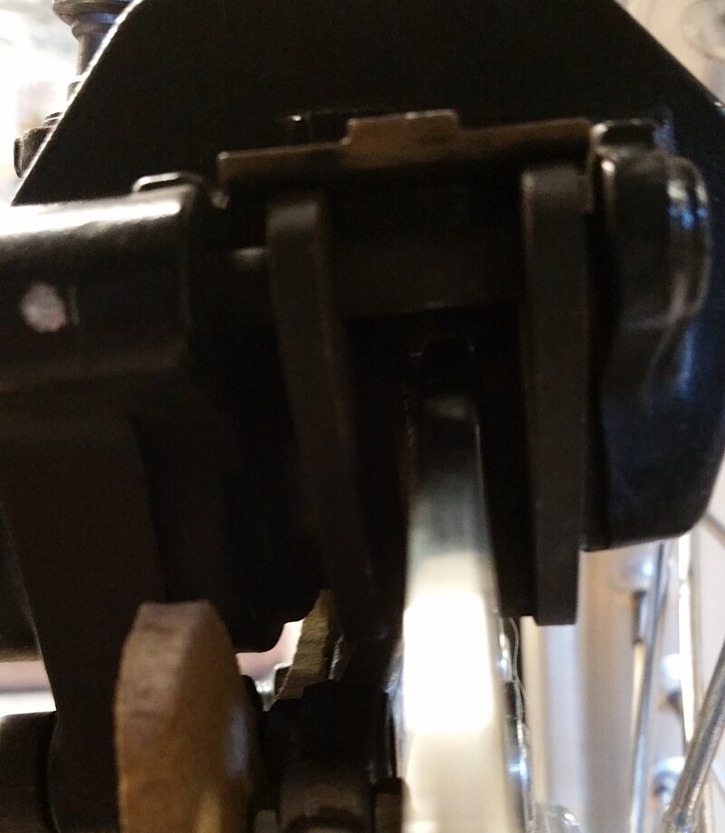

A straight on look at how all sits, yes this front edge of the caliper looks to close to the rotor, but
the back side is setting a little high, the pads edge is just a hair above the rotor, so mounting hole location is issue, lower the back some and the front might rise some if I do not use the center mounting bolt, once all is as needed, than mark and place the center mounting hole.

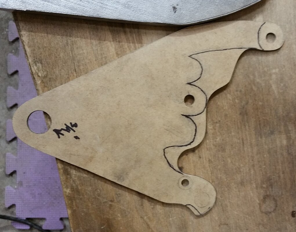

Play time and more patterns, LOL

So I got the correct thread and length bolts for mounting the caliper to the support bracket.
I played with travel motion and all that to make sure that the pads will ride the rotor all the time.
So the final pattern was crafted today with precise bolt holes and axle hole location. I got excited because it was done and worked out, now to put it on the steel and get it cut and shaped.

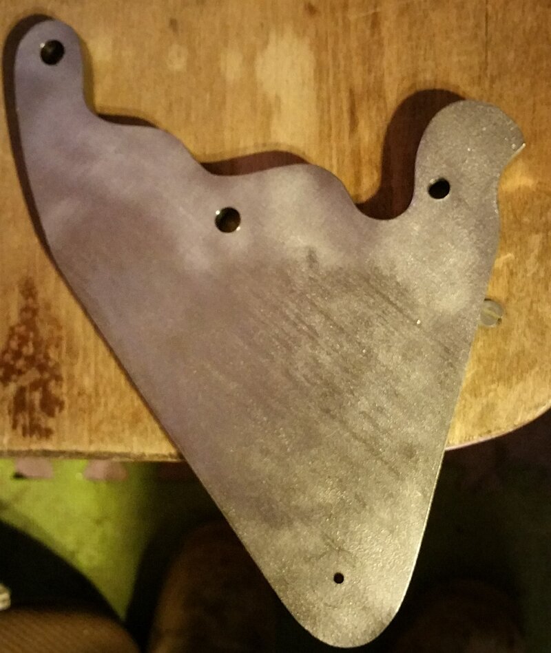

I did not do a super bad job, just a little extra grind time to get to pattern line.

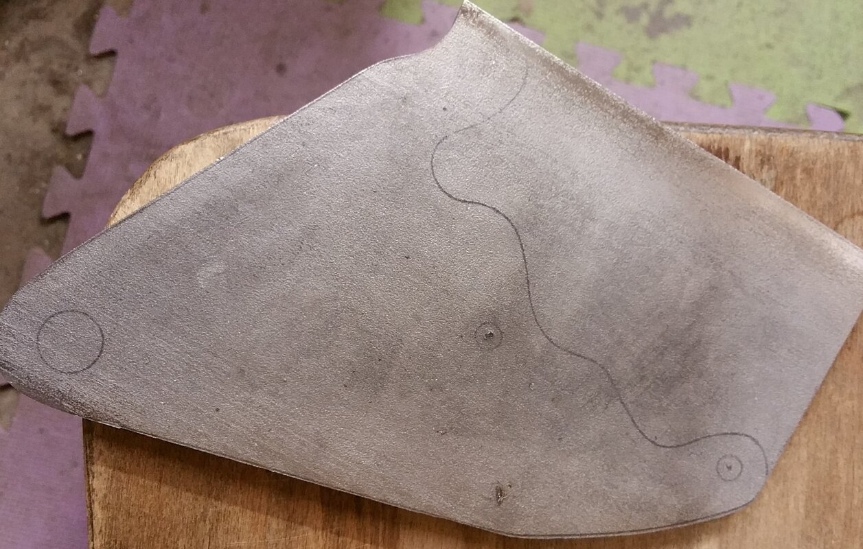

I got this far yesterday, just the top curvy line to cut out today.

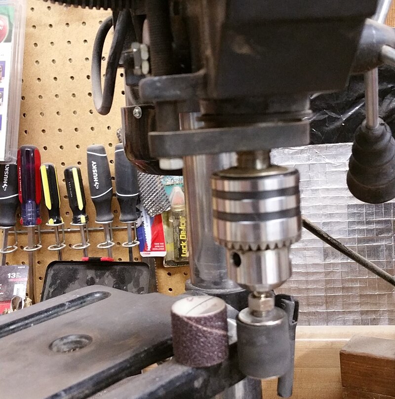

I could only fine 50 grit sanding drums locally, they take some time, but they do work on cleaning up the edges.
I just wanted a support bracket, but the daughter seen it laying around and had to put her touch to it, children...….
pic did not stay rotated, but I guess it looks like the "hang loose" sign

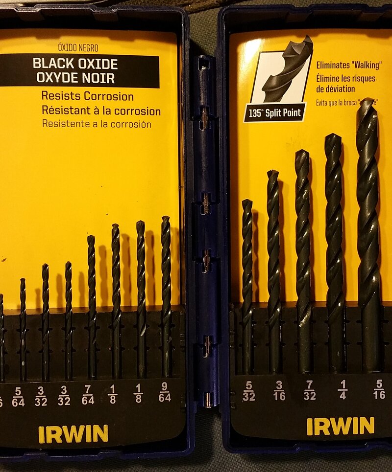

Those silver colored drill bits from the hardware store are ok for wood.....but little else.
Black oxide bits work ok....slow
Cobalt holds up... but is brittle and easy to break.
Real carbide is way way brittle and can not use by hand at all.
Use cutting oil and/or keep it cool. Cutting tools will burn up melt real easily in ss.
I use Castrol moly dee for low speed cutting lube.
Like most think a drill bit is a drill bit, but we have wood bit for soft, medium, and hard wood, duh...…. guess you would have the same for the different metals out there.

It just takes a lot of time and pressure against the sanding wheel to work the edges to the fine pattern line, really only have one major area that has to be dead on the pattern line, that top curvy line and that will take some time to get done.

Okay spent the last few days drilling holes in the 304 SS 3/8" thick plate. I read you and seen on you tube that you should drill pilot holes first. 1/8" inch is what was used the most, than step up, so the 6mm only had to do the next size up, the two 8mm bolts to an extra pass. Basically went in 3/32nd increments.
Used what local store had, thankful it was the recommended type drill bits.
