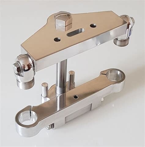

Harley used to make adjustable trees for sidecar use. I typed in Harley adjustable trees and I see some companies are making variations of them. They are for Harleys but it might give you some ideas.
Thanks for that. I was thinking this may have been done before. This one is very similar to what I have in mind.
