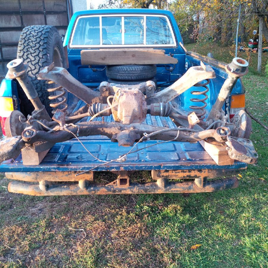

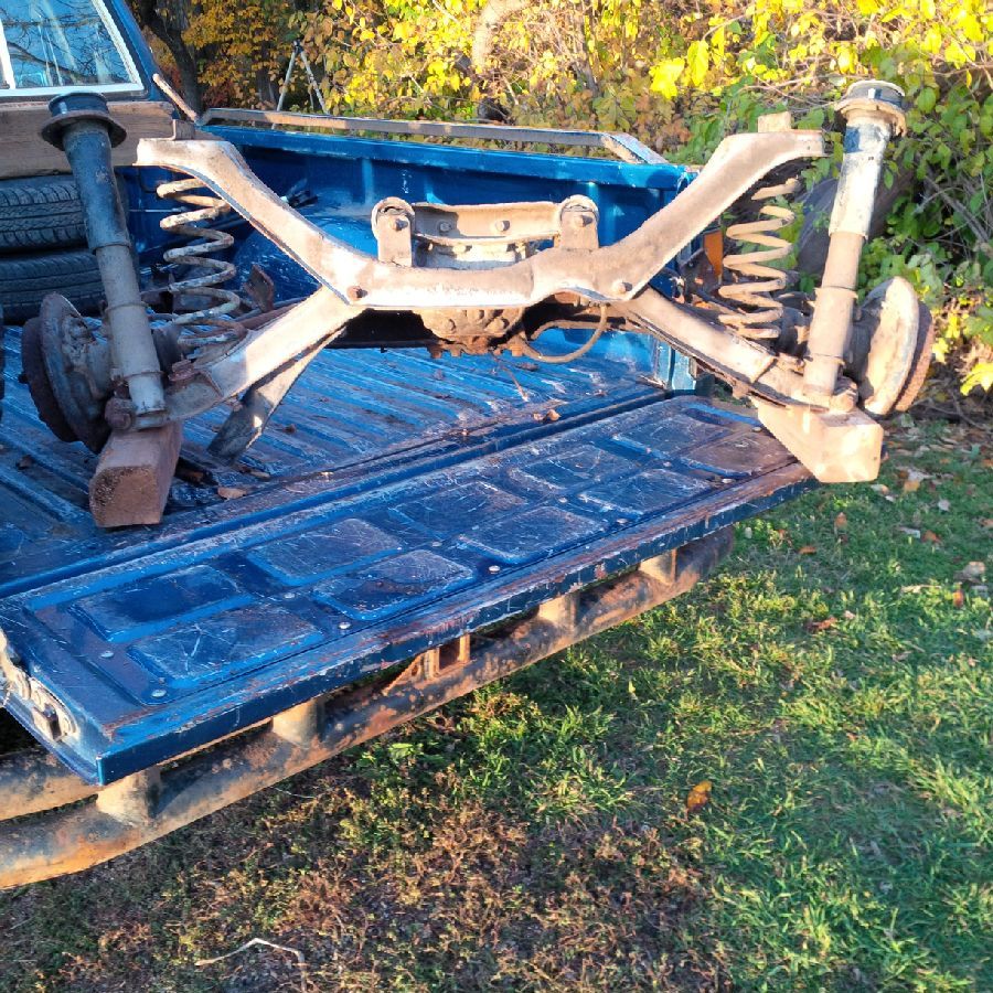

pics of the irs on the back of my truck
Here are pics of the irs assembly, still all dirty, on the back of the truck
Ratio of Subaru diff is 3.70:1 Ratio of CX500 final drive is 3.09:1 (11/34). So I will have to select as tall tires as is possible to keep my hwy revs down.
The Subaru setup is 53 inches wide at the hub-faces.
As it sits, the coils are fully extended, so the suspension is all jacked up way higher than one would want it to run. I'll have to find a way to squat it down, by shortening/cutting the springs, or by changing the springs out for some sort of airbags. Maybe getting several fat girls to sit on it ??

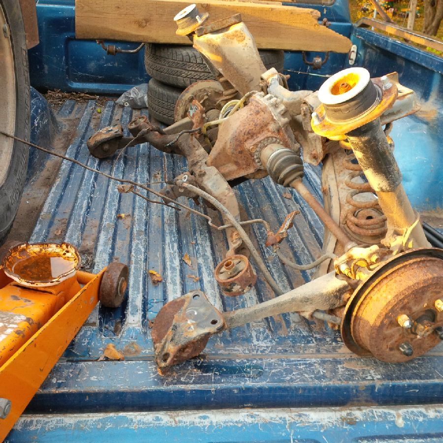

Strut top mounts
Yes, it would have been ideal if the crossmember had included top strut mounts; I will have to frame that up. The struts hold the knuckle vertical, so I will have to provide an inch or so of for-aft and side-to-side slotting of the mounts to provide adjustment of camber and trailing arm angle.
I'm hoping to be able to stay low-tech and use the provided drum brakes. I even managed to take off the flex brake hoses, recently replaced by the previous owner of the Justy.
I find parts such as the struts a little difficult to source. Not many Justys came to Canada.
