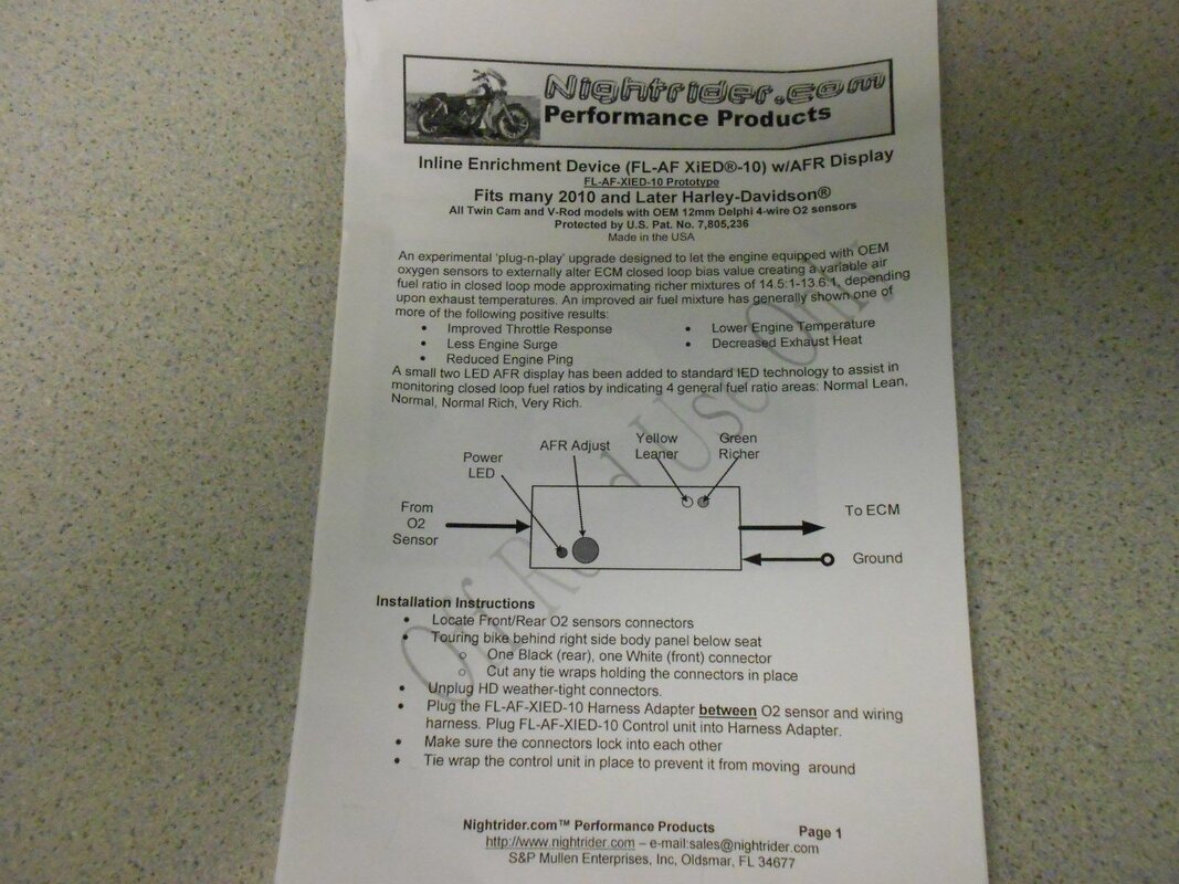

I think the Freewheeler trike stock runs really well. With that said, I still feel the closed loop fuel ratio of 14.6 from the factory is to lean for an air cooled motor. (We spend the majority of our riding time in closed loop)
I installed the Nightrider FL-Vied-10 units and set them to control the closed loop fuel ratio at 14.2 or at the 50% set point. I also tried the 75% or 14.0 set point and it was a tad to rich feeling for my set up. (13.9 to 14.2 are good ratios for the closed loop operation depending on the bike and the upgrades) ThumbUp
My Freewheeler runs very nice at this set point 50% or 14.2 ( My set up= stock air box with K&N replacement air filter, stock ECM mapping, D&D 3 1/2" slip on mufflers with the 2" Vortex baffles) The idle and cruz is smoother. The throttle response is crisp and solid and the very small amount of decal popping I had every now and then is gone.
The FL-Vied-10 do exactly what they say and are a cost effective way to increase performance and cooling when a full blown tuner is not needed.

glad you posted this bill, beings i took the fl-xied-10 off my ultra before trade in, and was wondering if i could use them on the F/W, being all that was done on the ultra was slipons big sucker air and i left the cat in. and all i plan to doing with the F/W right now is K/N filter and slipons, and i hate to see them just set here ya know, so what do you think ?
I think the FL-Xied-10 unit you mentioned is the non adjustable version and has a fixed variable for the fuel ratio of around 14.0. In most cases I think most bikes will run well at that ratio. My set up felt a tad rich at the 14.0 ratio but would have been ok, just felt better at the 14.2 ratio.
The FL-Vied-10 has the adjustable pot on it so the fuel ratio can fine tuned in the ranges of between 13.9 to 14.3 or 14.4 with the 2010 and later touring model Harley's with the 4 wire heated Delphi oxygen sensors.
There easy to install so I would say give the FL-Xied-10 a try and see how they work. If the fuel ratio is not right for you then the FL-Vied-10 adjustable units are only $119.00
let us know how it works out.

I took another long ride today with side cover off the Trike so I could have access to the FL-Vied-10 setting adjusters. I also took a small jewelers screwdriver to make adjustments as needed.
I tried both the 45% and the 50% settings and the 75% setting again. Hands down the 50% setting worked best for my set up giving better throttle responce and no decel popping. The 45% setting had weaker throttle responce and some decel popping. The 75% setting was like I said before a tad rich for my set up and did not provide as crisp of throttle response, more sluggish feeling.
50% is where I will keep the FL-Vied-10 units on my Freewheeler Trike. ThumbUp

I bet you a Dollar to a Donut the 50% set point will work great for you. I have done a lot of research and it seems like the 50% set point seems to be the sweet spot for most Harley set ups from stock to slightly modified. ( My 2012 Fat Boy liked the 50% setting as well with the FL-Vied-10 units installed on it)
Don't forget there is a nice grounding block just inside the frame on the right side on the Freewheeler. With your seat off you will see it, the ground block has the battery ground and the rest of the bikes grounds going to it. (A perfect spot for your ground wires. These ground wires are critical for proper function of the FL-Vied-10 units).ThumbUp

I actually got the FL AF XIED 10. My bad :xzqxz:.
It was very easy to install, and thanks for the tip on where to attach the ground wires. I did not make any adjustments yet as I did not get to take the bike out for any length of time and it rained all day today. Hope to get out tomorrow and will post my observations to all of you who asked my opinion.
