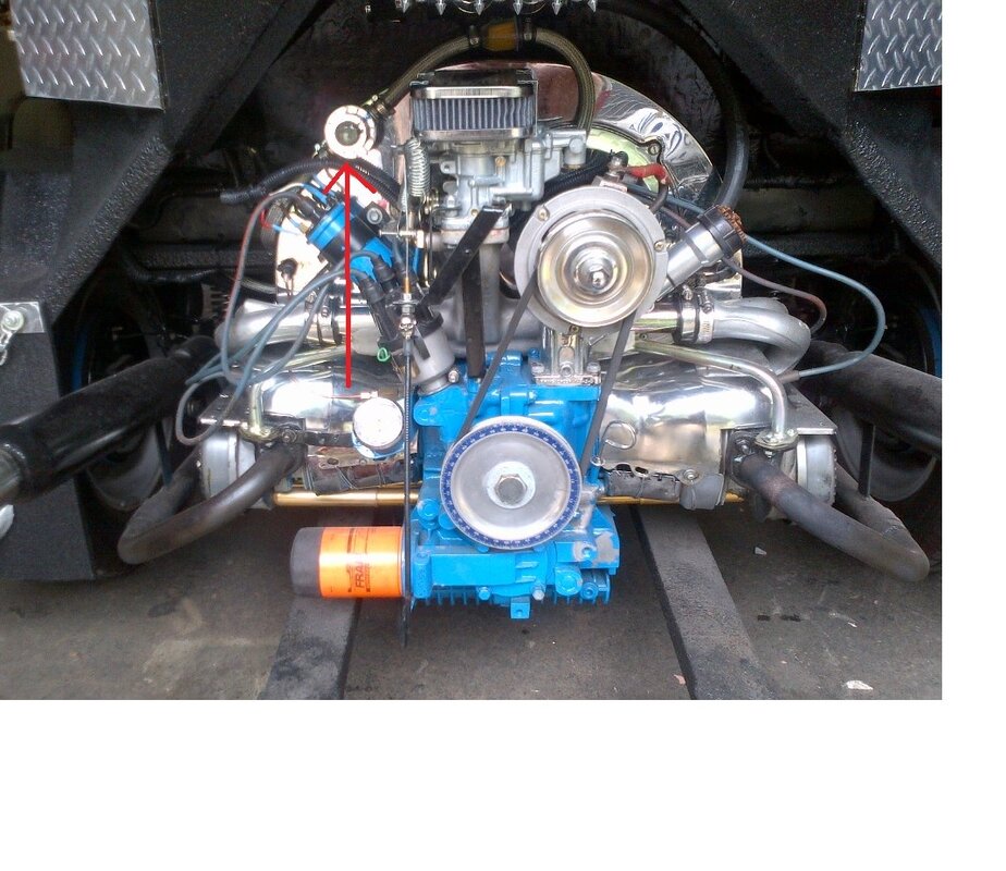

So I am just wondering why use a manual pump?
I just put a block off plate on mine and I use a electric pump.
Is there some advantage of a manual pump I am not seeing?
Apples to Oranges .....:Shrug:
