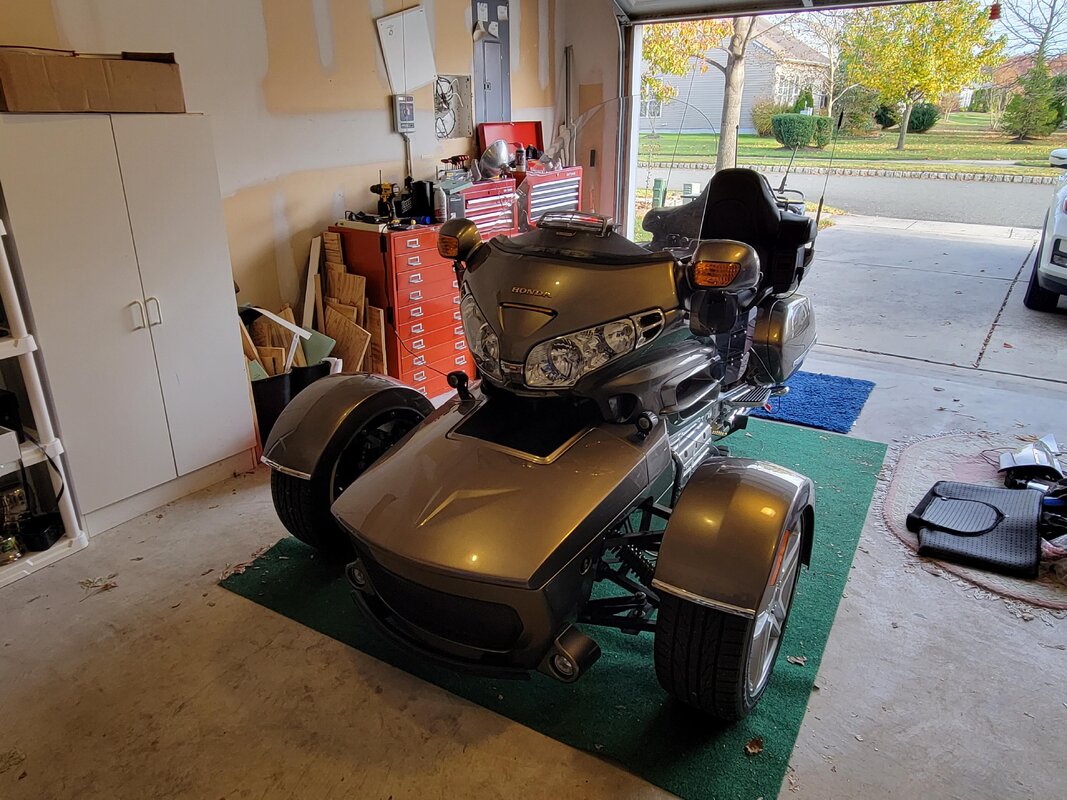

Prowler RT

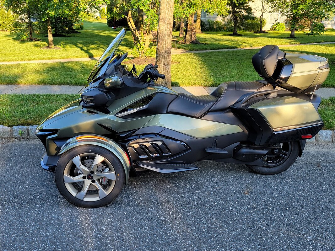

This is the 2021 Canam Spyder Sea to Sky I had for a while until the stereo system went bad and so far it can't be fixed. The bike is in pieces at the dealership. I traded it in for a 2021 Spyder F3LTD, which I had for a few months and then sold it and bought a 2004 Honda GL1800 with the Motor Trike Prowler RT kit. I love variety. I lose money on every deal but I make it up in volume. LOL.

Prowler Reverse Trike

I have a 2004 Honda Gl1800 with the Prowler RT by Motor Trike .

PROWLER RT on GL1800

Prowler Reverse Trike Kit

Prowler RT on my 2008 Goldwing
