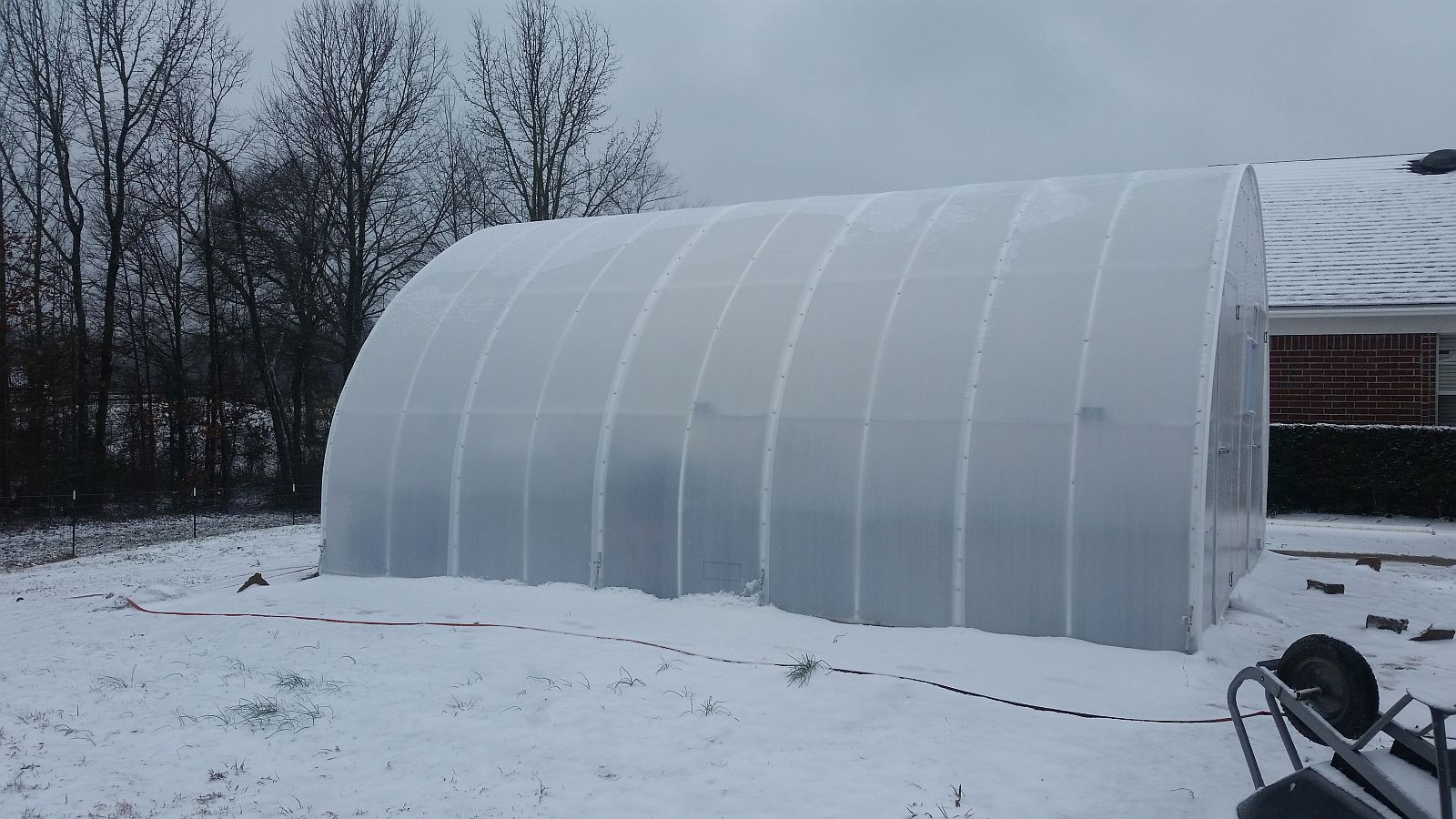

Mary grows a lot of our food in her garden. However, we are usually on bike trips during the prime growing season, which has been frustrating for her, and limited what she could grow.
So we set up a greenhouse so she can grow our food year round.
This is a pic of the outside, 1 week after she first planted in it. Taken on January 22nd-

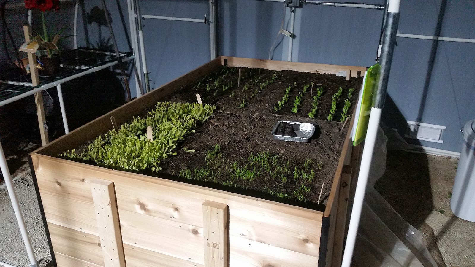

This is a couple of weeks after this first use, taken on February 2nd. In the teens outside!
Photo taken today, March 3rd.
