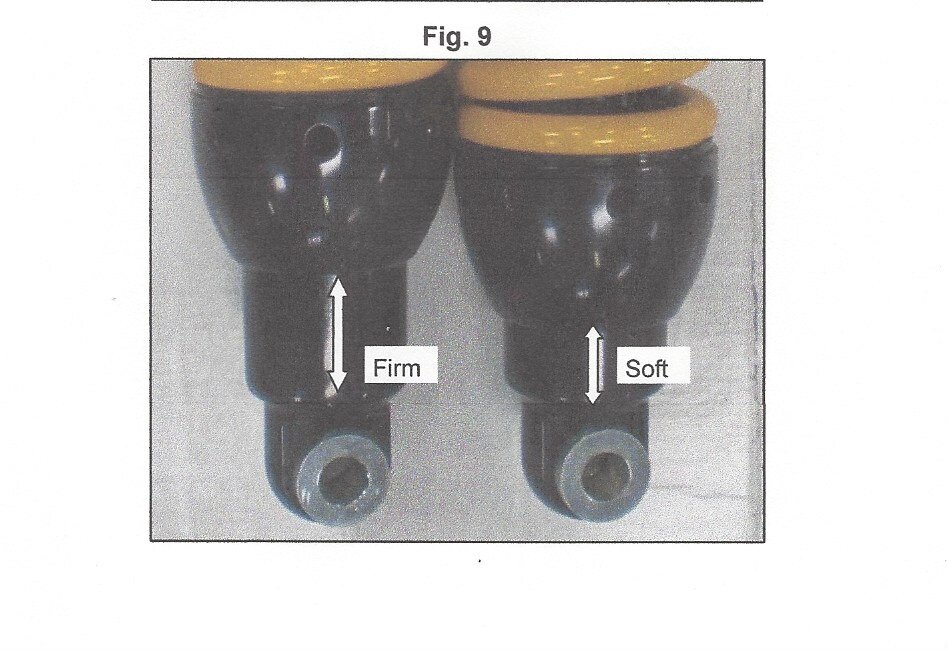

What I meant to say on the red colored shocks is I have compressed the springs from min. compression to 5 turns in to compress the springs thus putting more outward pressure on the shocks-so is the suggestion to compress the springs even more to bring camber into alignment which will raise rear and create a rougher ride--
tire mileage
Thanks for the suggestions ---I will try compressing the shock springs to see if that corrects the proplem
