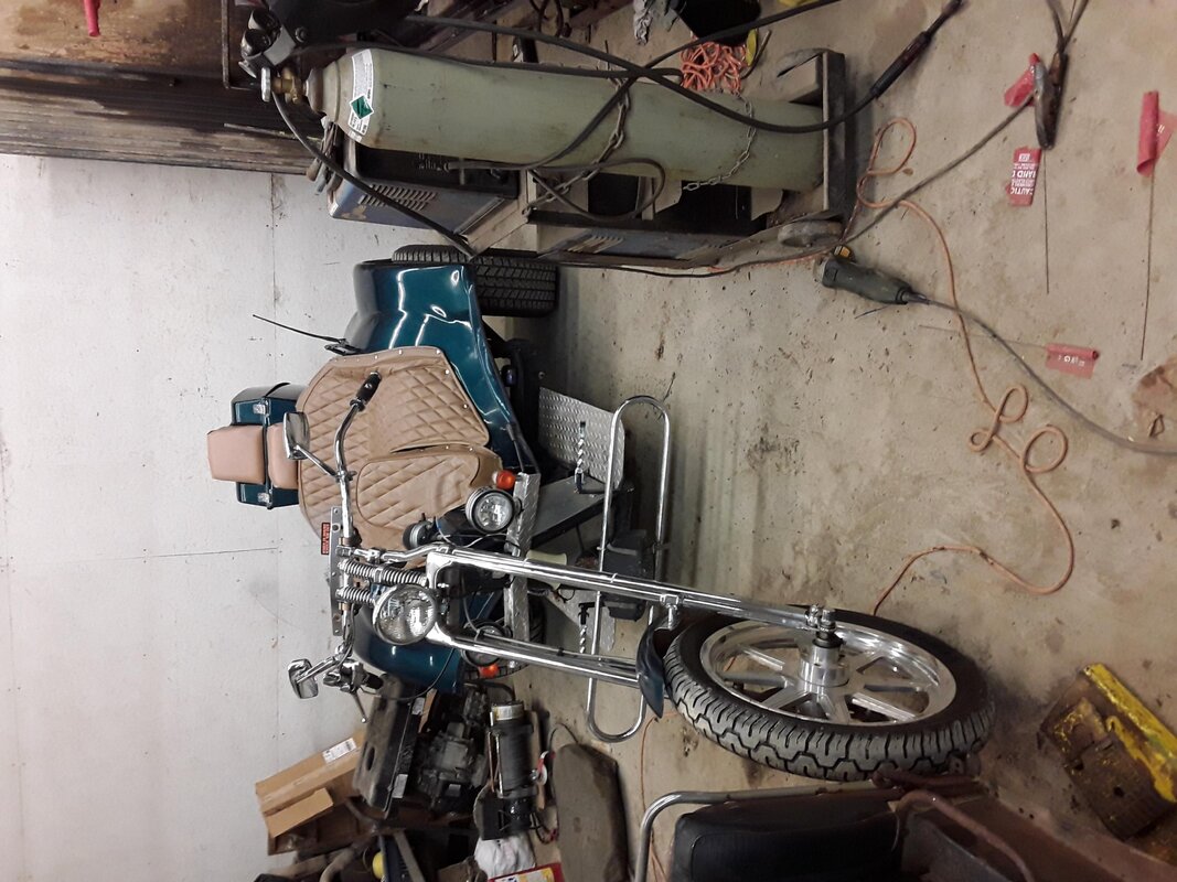

My winter project.
Nice looking trike, Bill.ThumbUp
What are your winter plans for the trike?
I want to refit it to me. Have to move the clutch and brake pedals forward a lot. Would like to add a foot throttle. The throttle is like a light switch, on or off! I was told the trike has a 1600cc engine that has been bored out to a 1776 plus it has a radical cam in it. At about 40mph in high gear it takes off like a surface to air missile. First time it did it, I was thinking it was going to be a clean up for the old Maytag! Possible repaint and who knows what else after I get into it.

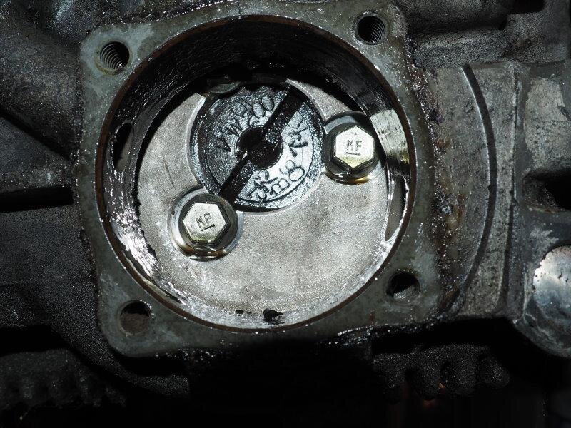

This is exactly what we are going to find out! I need to change out the clutch too. It's a race clutch and it's either on or off. I will let everyone know what I find out as I go along. Are there any markings on the cam which would be visible when pulling the cover off. I was told it might have a big cam in it. The guy that I bought it from said he had hotted the valves. I've never heard that term before but I have a feeling that means big.
Problem with VW engine is that you have to completely tear down the engine, split the cases to access the cam. You might be able to pull the oil pump and see if there are any markings visible through the hole on the end of the cam. I'd recommend taking time to read over the VW trike threads especially Snu's Tech, tech, tech thread. There are several books and small specialty tools that you will need to work on the engine that are mentioned in these post. Post pictures as you disassemble and somebody should be able to help.
Cam stamped on the end.
You can see it once oil pump is removed.
Can not do anything with it until fully disassembled though.
