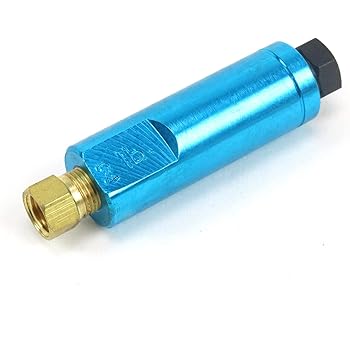

Does your system have a 'residual check valve' in it ??
You should achieve pedal pressure at this point.
If the pedal seems to pump up, slowly re-bleed the wheels again.
If you leave unattended and return later to find you have no pedal, residual check valve time.
Hope this helps.
