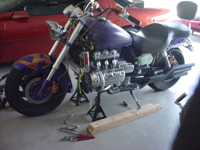

Thinking of repainting the purple monster and adding a batwing and trunk. Just looking for something a little different after four years.
