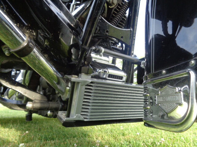

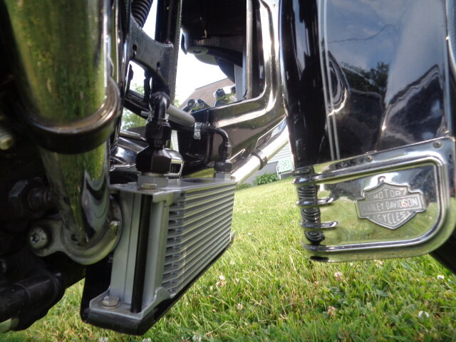

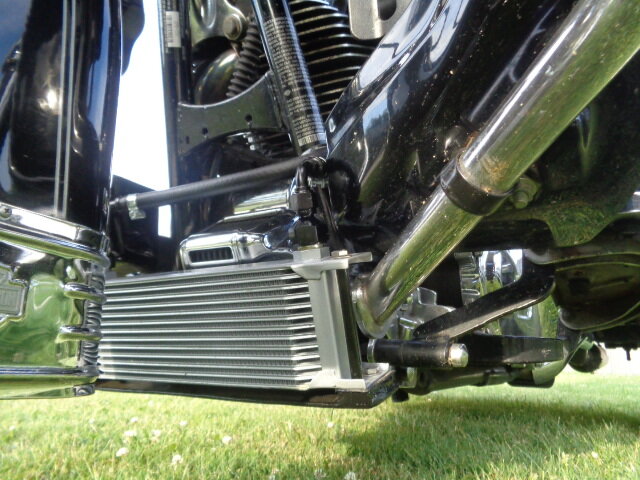

One thing I only now just thought about. Have you fully compressed the front forks (simulating hitting a big bump) to make sure there is clearance between your fender and the new oil cooler?
Thank you for your input I tried to check that as best I could. The new oil cooler looses only about an 1/2 to 3/4" to the old OEM. I don't know of a way to fully compress the forks to see. As you can see there is a little difference I made every attempt to keep it as low as possible to avoid interference with the fender. Any suggestions on how to compress the forks would be greatly appreciated. ride safe Fred
compressing front forks
put the front wheel in a wheel chock and snug it down with tie downs

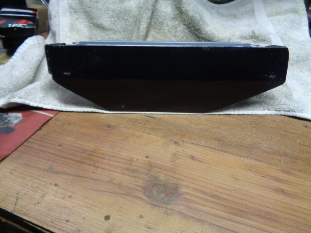

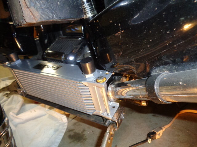

I ended up using a 3/8" piece of strap drilled and tapped the pictures here show R&D wood spacers for try and fit. Previous Pictures I used were with the 1" box iron.
It's a bit of a PITA with the fairing, but ratchet straps is how we've done it in the past. I would Not use the handlebars.
The reason I thought of this is that I have seen a few 2 wheel Ultra's that have had a ding in the front fender after hitting a hard bump. The combination of totally compressing the front forks AND a bit of flex in the fork tubes ran the fender into the regulator.
Of course the TG has more rake, so that fender is further away, but it also seems like the oil cooler is sticking out further.
Probably no problem, just like to double check everything.

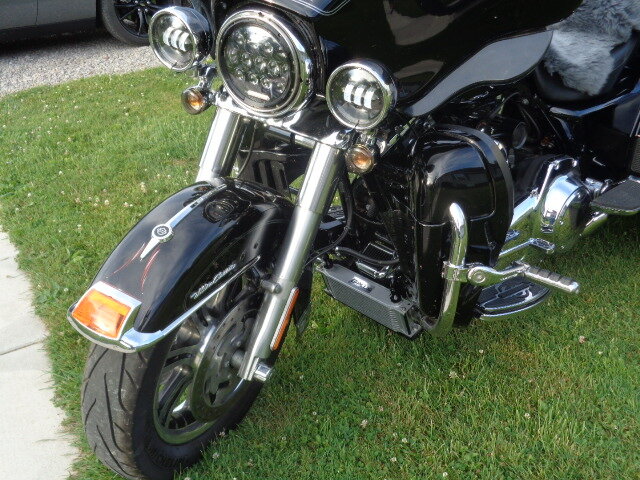

Thinking about installing an oil cooler as described, says it mounts in the fairing behind the vents ? Looking at the picture , it don't look like any space left unless it mounts in front of the vents, is that where it goes?
I believe the one Kevin uses is one that attaches to the frame upright on the front to the gooseneck. It may possibly be a Jagg oil cooler. I could be wrong though. Ride safe Fred
The Oil Cooler package for the Twin Cooled bikes (Twin Cam & M8) can be seen here, at this LINK, with a bunch of photos.
The Oil Cooler, which is a Jagg, combined with our patented Mounting bracket, mounts right behind the vent in the lower left fairing.
Here is a photo of it-
Here is a video with some more info on it-

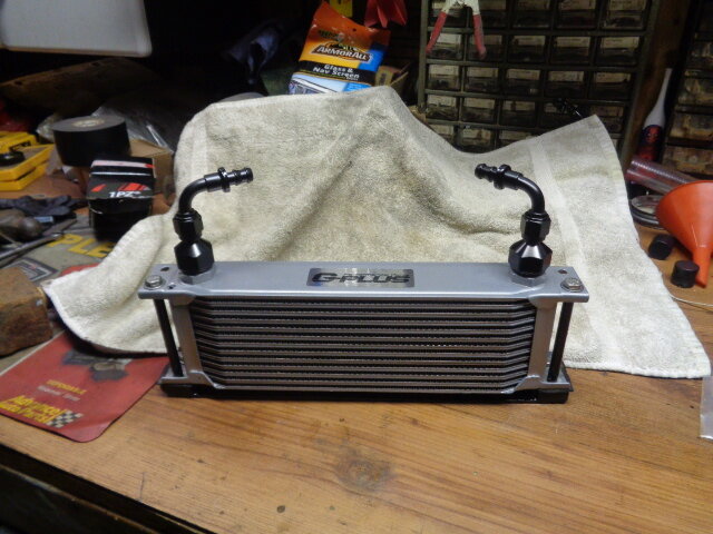

Just to update this thread I'm ready to have the new mount welded and installed. I'm waiting for warmer temperatures, I have ridden the trike and checked the oil temps. however riding with air temps. at 55* the oil only goes to 185* and ET 208* and it would not be a good baseline comparison.

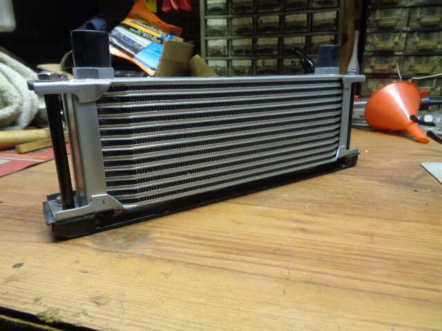

DSC01575.JPGDSC01576.JPGDSC01578.JPGDSC01496.JPGDSC01507.JPG Last two are close to fit on the larger oil cooler OEM is really small. Fred
View attachment 84529View attachment 84530View attachment 84531View attachment 84532View attachment 84533 Last two are close to fit on the larger oil cooler OEM is really small. Fred
Dang, that thing is a beast .. I Love it ... that'll keep old shiny KEWL ... :D

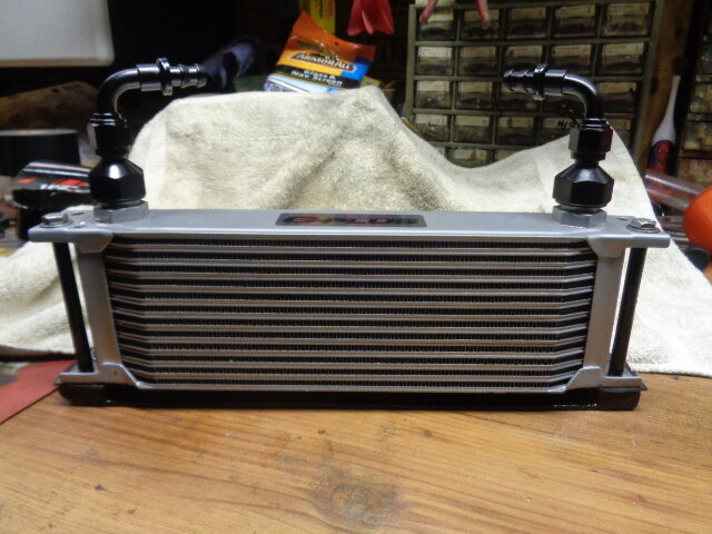

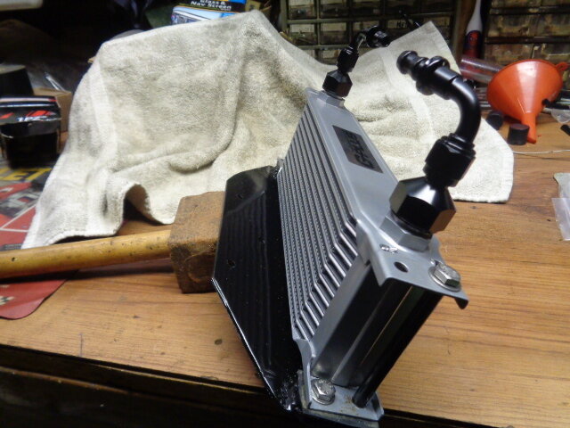

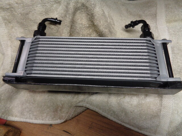

Welded up getting closer to final install...
Well today I got the Mig welder out and attached the mounts to the adapter plate. bolted up the cooler and loosely installed the oil line fittings. I hope all goes well with the final fit. The last outing the oil only went to 215 degrees and I know it gets warmer than that. The air temp was only 60 degrees ET was 225 degrees not warm enough to get good baseline for comparison. I still need to get new oil lines next week.:DDSC01607.JPG Ride safe Fred
Well today I got the Mig welder out and attached the mounts to the adapter plate. bolted up the cooler and loosely installed the oil line fittings. I hope all goes well with the final fit. The last outing the oil only went to 215 degrees and I know it gets warmer than that. The air temp was only 60 degrees ET was 225 degrees not warm enough to get good baseline for comparison. I still need to get new oil lines next week.:DView attachment 85354 Ride safe Fred
View attachment 85348View attachment 85349View attachment 85350View attachment 85351View attachment 85352View attachment 85353
This is really looking good! Very nice work.
