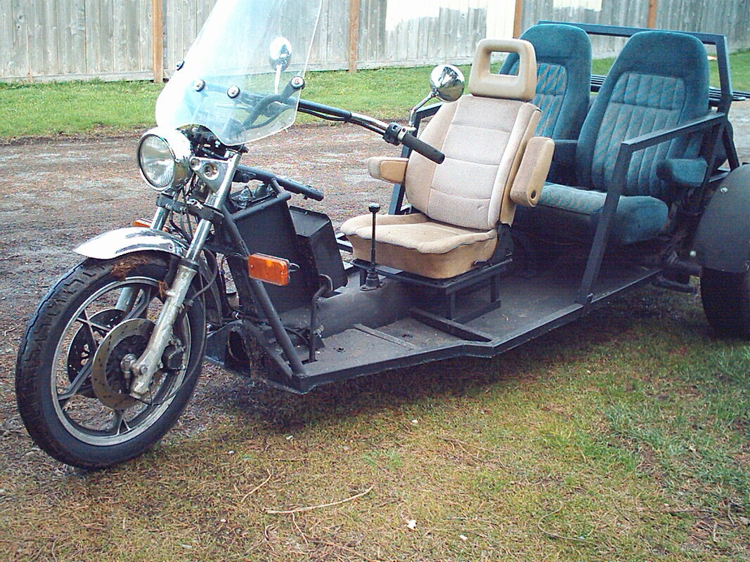

Thanks for this. I live away from town so am looking to build a VW trike cruiser. All highway. I'm using an old car seat to kinda get an idea as to neck height but am thinking I should order some seats that sit lower before moving on. Seems like every step in a build is filled with questions. I need a seat that lays back. Had 6 surgeries so far including on my back. Checked with Summitt Racing--can't really tell what would be comfortable. And the height is difficult to judge. Guess that's why people build their own seats. The height of my floor (tube) appears to be around 13-1/4". This is with 25-1/2" tires.
I want 28" to 30" tires eventually so the frame that goes under the seat will be higher off the ground. I couldn't begin to tell you what I would need in a gerder. You must build these from scratch huh? Oh yea--I'm also contemplating cutting the tunnel in front of the vin number so that would stay on the trike. This would change the height of the floor considerably. I have never cut the tunnel on a beetle and have no idea what to expect when I do. I see some people mount a flat plate vertically on the tunnel after it is cut and weld their tubing to the plate. Lot's of stuff to consider. Thanks again

Mine is completely tubing and has none of the car frame/springs/arms at all. Most of mine is either mounted backwards and or upside down. So like I said.... build to your taste.
A lot of folks build a leading link front end. It seems to be the most simple way to get the numbers to fit together and is also not a too complicated build.
The shift rod, the clutch cable, the fuel line and the accelerator cable all run through the tunnel. If the tunnel is cut off you would have to deal with those things. The tunnel gives the VW it's strength, it's the backbone of the car. The floor pans and the heater channels kind of just hang off of the tunnel although they do add some strength. I've seen VWs with totally rusted floor pans and heater channels still being driven.
If you keep the tunnel as I did then the seat will have to sit on top of it but on mine it worked out to be a good height even with the 30" diameter rear tires. I used a seat from VW Vanagon but nearly any seat would work. Mine slides up and back and reclines just like any car seat. But heck, there are a about a million other ways to build a trike. I built mine so I could sit on it all day and be comfortable, I'm too old to sit on a motorcycle seat all day, I did that when I was younger.:laugh:
My first intentions were to leave part of the tunnel on--especially where the vin number is under the rear seat. I thought it would be a good idea to leave the shifter intact right where it is. So much for the tunnel--it's now gone. if I can figure out how tom attach a pic or two here I will send my build along. Thanks for your input. If I get these pics to load, can anyone tell me if they thought about a frame that pertrudes out of the rear axle assembly in this fashion? Thanks

I got a few pics to download here (ABOVE). The tubes sticking out are 1-5/8" tube O.D. that I picked up at Home Depot. These are fence posts actually. They went in 12" or so and could be welded in. Of course I'm going to use chromoly eventually and maybe try using 1-3/4" O.D. if I can find something this size. The pipe lean downward toward the front of trike frame so that's a concern. I'm thinking that a plate could be built to cover hole and add support the plate could also be for attaching more frame material. Any opinions out there?
DOM tubing is the easiest and most common to use. It is mild steel. Chrome moly is not required for a plain application like this.
Steel (not iron) water pipe, EW (electric weld) tubing and DOM tubing are all plain carbon steel. Steel pipe is not very uniform in wall thickness and quality. EW tubing is much more dimensionally correct and better. Both of these have a weld seam to work around. You must turn the weld seam (visible inside the pipe or ew) to the inside of the bend and also watch which way the load forces will be. It can be done and used to be the only thing available to work with back in the day. Lots of welds, support plugs in the splices and fitting and grinding.
Now there is DOM (drawn over mandrel).
It is the same as EW but as the name implies it has been drawn. The weld is worked in and normalized. You now don't have to clock seams or even pay attention to the physical properties of the pipe/tubing anymore. You can just pick it up and start bending compound bends every which a way.
Square tubing is strong until you have to bend it. So for the most part it will need to be a lot of straight pieces instead of bends.
Many a trike has been built using the original vw design concept. Replace the tunnel with a large piece of square tube cut and angled up to the neck. Then add on running boards.
