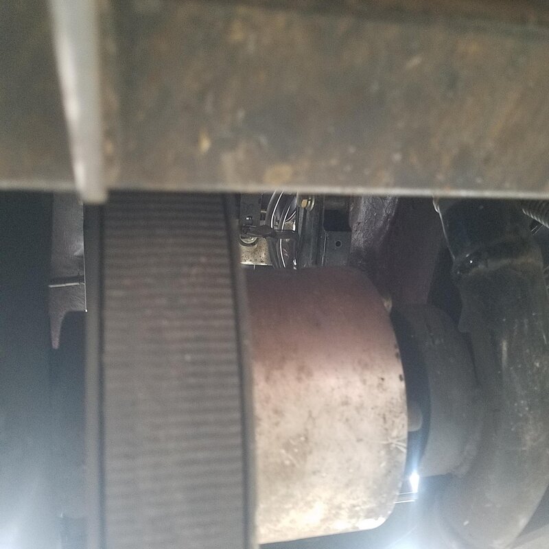

These are photos of the rear end on my 98 Ultra classic. Have no idea of the kit year. Am having something between a click and a clunk per revolution below 10 mph. Need to check grease. It has 2 opposing hex plugs, looks like 3/4" hex key size. Any info or advise greatly appreciated. Ken
One thing to take a look at is to check the bolts that affix the pulley to the differential housing and see if they are backing out, I've seen this before on the older models. You can grab the rear of the pulley itself and give it a firm back and forth shake and see if there is any play in it.
Thanks, Papa....I will check that out.
It was an axle housing bearing between the belt sprocket and the differential . Ball bearings fell out on the floor it was so far gone. The clunk noise was the bolt heads holding the belt sprocket hitting the inner axle housing when turning. I now know EVERYTHING about my trike. Ken
Had the pulley bolts themselves started backing out of the differential housing?
Negative, Papa. Everything was tight. Big inner axle bearing next to diff. housing was so far gone it tweaked outer bearing and allowed axle to move horizontally about 1/8" which allowed the sprocket bolt heads to contact the inner axle housing edge. Inners were $70 each, outers $22 each. Made sense to replace all with the "good ones" while in there. Spyder gears looked like new. Packed housing with heavy grease and good to go. Ken
Check for a rock in the belt. It will make the sound you describe,
