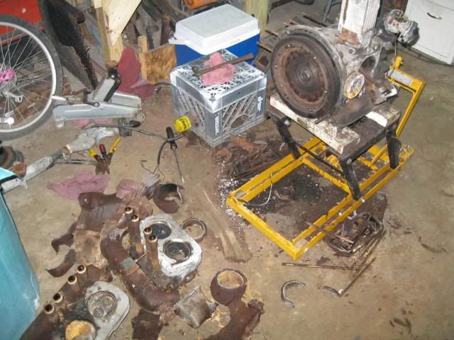

Last night we got the motor off.

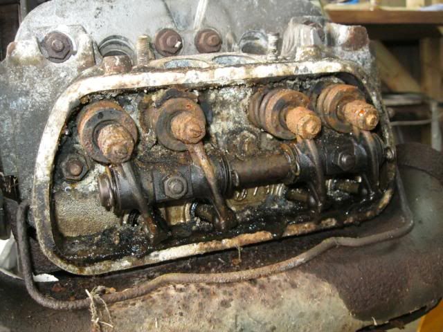

There was no drain plug for the oil, Just a plate with 6 nuts. so off it came and on the plate was a 1/2 " thick layer of sluge. nothing came out. A little scrape with the screw driver and a trickle of water started. Clean water. Then came the oil and it really didn't look to bad. Strangely enough it wasn't milky at all the oil and water were not mixed and stayed separated.

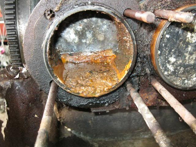

The crank does not turn. Could be the rings are stuck, lets hope.
The rest of the belt is stuck in the crank pulley
Can we say challenge.
Here is the oil drain/ screen plate.
I think I can clean the pressure plate up. But the clutch is toast. There is clutch dust laying in the bottom of the flywheel

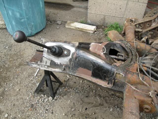

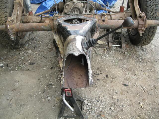

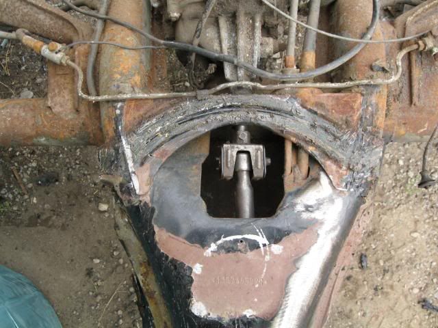

I moved the shifter back 30"
while I was at it I found the main shaft to be kind of loose so... There is a trany rebuil kit avalible for about $130.
The shift shaft isn't purfectly stright so I think I'll cut it back out and set the box in a bit.

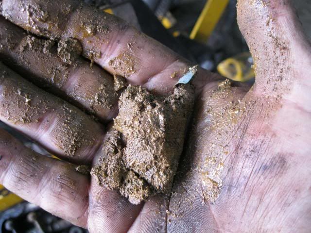

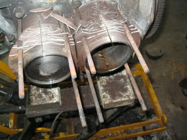

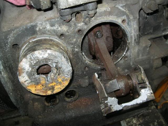

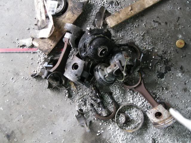

Look what came out of #1 cylinder.
the pistons where solid in the jugs so I had to break them out with out screwing up the cases.
I know I made a mess.

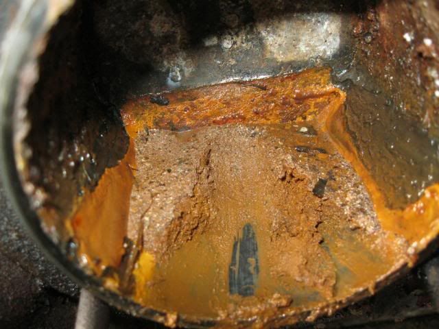

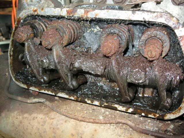

It is fun trying to figure out how things happen. Like the 3/4" of clay in Number 1 cylinder. The cases are salvagable. The heads can be rebuilt. Not that at this point I will use either, we shall see. The story that I got was that this buggie ran when it was parked in 1985. Not well I'm thinking. The transaxel is worn out the points and rotor are burnt. The plugs looked very rich. We Can Build It.<br />

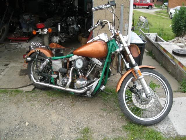

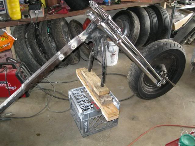

I started on the frame I have 750 that has a titled neck, Sooooooooo, I cut the neck. The motor goes to my son for his chopper project.
And this is My Mistress. ( Wife named her).

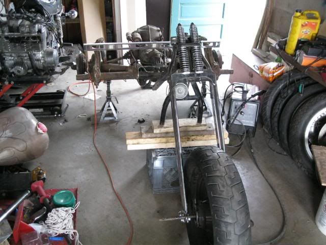

There is more frame done now, I'll get picts up soon. I'll tell you what after building the shovelhead, the prices for VW parts is easy to take.

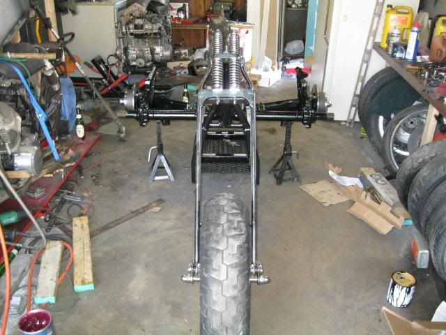

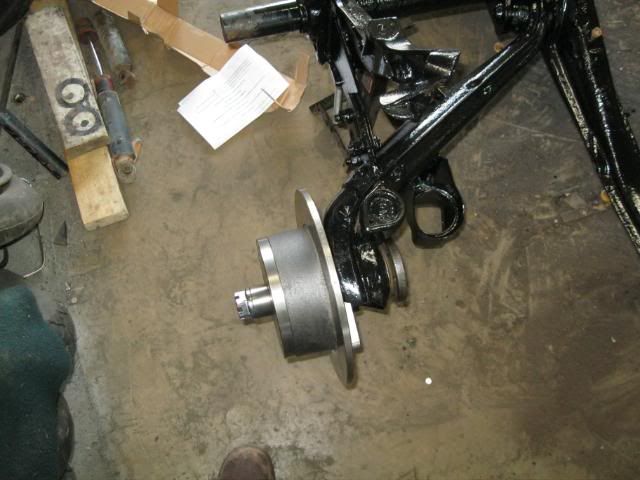

Frame is painted and new brakes are in a box in the living room. I think by saturday I'll have it sitting on three wheels. Picts to come. After doing the math on parts and time I think it would be wiser to buy an engine.
frame is painted and rotors are on
