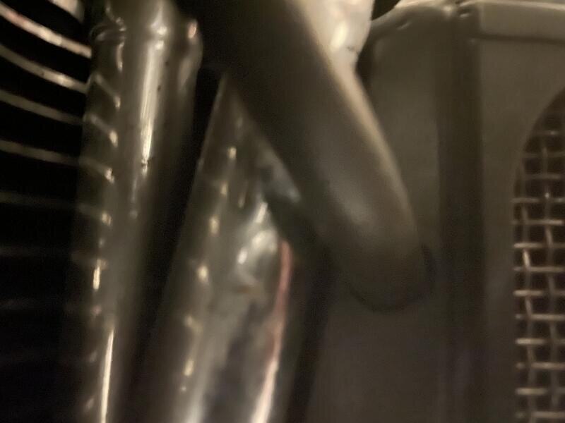

It was done on my 20 Tri Glide, Hope this helps. The photo is flipped upside down. Part of the casing is behind the valve assembly, so you have to drill closer to the front. I drilled a pilot hole and used a step drill to get a smooth hole. As you can see there is not much room.

Thanks for the pic, was looking at the front of air box myself and then run it down to underneath the floor board, just curious what size hose is that?? I have a 7/32 hose which fits the breather bolt really good.

Sorry for the late response! Not sure since I received the kit from DK and the hose was with the kit. Measuring the tube looks like 5/16 outside and 3/16 inside, that just eyeballing with ruler. May want to DK and ask the size of their hose.

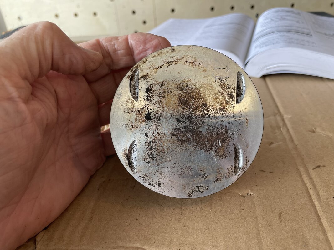

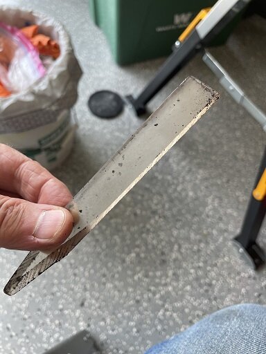

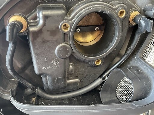

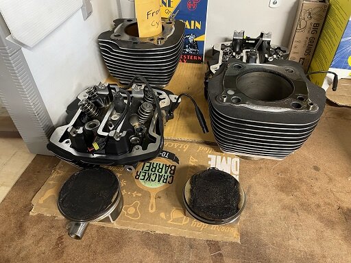

When I bought my 2019 Electra Glide Standard, I had no intention of running external breathers.
I have always kept the oil on the lower half of the dipstick (I have never been one to constantly worry about oil level, in my opinion if it shows up on the marked area on the stick you have enough).
But during an unplanned teardown at 15,000 miles I saw that the tops of both pistons were encrusted in carbon, so much in fact that I could not see the arrow that shows which way is front on the piston.
I scraped the crud off with a plastic scraper.
I routed the breather hose out of the air cleaner and routed it overboard.
The way the OEM breather hoses are configured in the air cleaner, I think the engine actually sucks some of the oil into the throttle body.
Since rerouting the breather I have not seen so much as a drop on the end of the breather hose.
When the warranty runs out on my `22 Tri Glide, I will reroute its breather also.
View attachment 114471 View attachment 114473View attachment 114472View attachment 114474
The OEM breather hoses go in the back of the air filter where they are subject to a vacuum
This is why that crap gets sucked into the intake
I have externally vented my bikes since the early evo days, keeping that crap out of the intake and combustion chambers, big plus in helping the engine to run and breath better
You could go ahead and vent your M8 now, if you have to take it in for any warranty work just undo the breather and put it back to stock in about 15 minutes, I have not put mine back to stock on my 22 M8 and it has been in the shop a few times with no problems from my dealer
