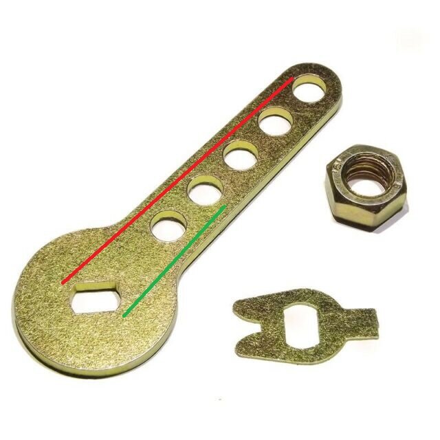

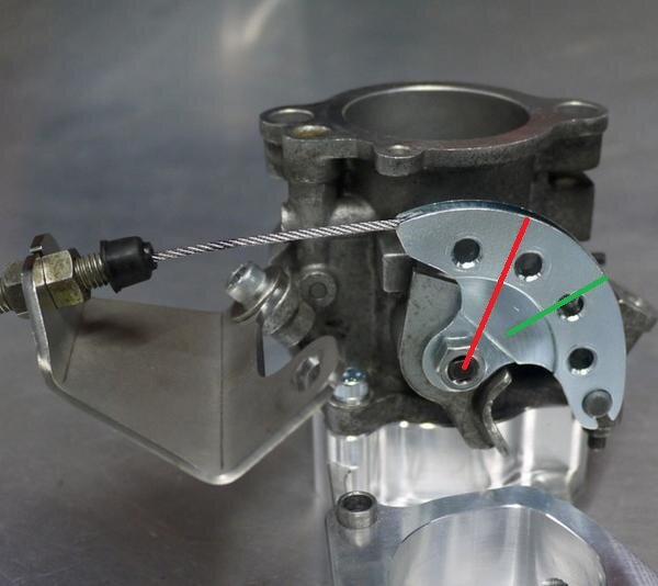

Picture version of Rex's reply:
Red line distance = more linear cable travel with less applied force.
Green line distance = less linear cable travel with more applied force.
The last picture is a bellcrank solution that will modify the different required linear travel lengths.
Hope this helps. Rex, correct me if I'm wrong.
Yep.
And the throttle on the top pick is nice. I like the arc section a whole lot more than a simple lever.

but seriously moving the cable end closer to the center will probably be the easiest... but if you have the round cable guide in the first photo you will need to remove it in that photo the distance from the pivot cant be changed
just in case the bell-crank didnt make sense .. hopefully this will help ..as mentioned some trial an error will be needed i think i would start with the hand throttle cable at least 1-1/2 inches from the pivot
