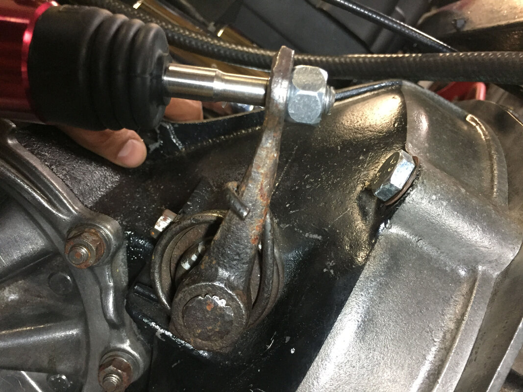

~ I am currently building a VW powered monster of a trike, and I'm in the semifinals, but the conversion to a hydraulic clutch system is where i hit the wall. I will try to describe what is going on to the best of my ability. I have a C&C slave cylinder properly installed, a 3/4"master cylinder as it is recommended, my flywheel, pressure plate and clutch pad are the correct type for my type 1 VW transmission and are new and in perfect and working condition, all the torque values are correct... I bled the system 3 times, and made sure there was no air in the system and at first everything looked to be working fine... but ones I got the engine fired up, the clutch would not disengage...

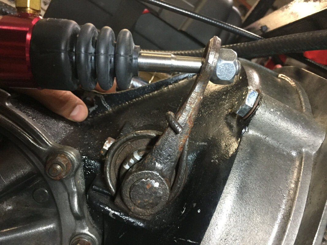

after a very complete Inspection, I found that the slave cylinder would only actuate up to the place where the throw bearing engages the pressure plate fingers, and stop. no mater the adjustments on the slave cylinder, it would only go that far... I took all the slack out of the slave cyl. push rods and the pedal was unmovable. I can disengage the clutch i by using a pry bar on the tranny throw arm... I also had the company that sold me the slave cylinder, send me a new one... but it made no difference.
Thanks,Cesar.
,SlaveMasterSlave top view

I can desingage the clutch with a pry bar, and don’t have to even push it all the way, and I can get in to gear with out grinding -
I bled the system 3 times, and found no air at all the last time, after pressing the pedal and adjusting the slave several times... I also checked for leaks and found none... how can I check for a bad master cup?
At first it seemed to work?
As in it did draw in the lever.
But then later it did not release the clutch and when you inspected it, it was not drawing in the lever.
You operated the lever with a bar and know it moves as it should.
So now you push the pedal down it takes out the slack but does not pull the lever even though the pedal continues to travel down.
The pedal moves and the slave does not?
As you changed the slave and the fact that it would be leaking fluid out, I doubt that is the problem.
The number 1 cause is air. If that is eliminated that leaves the master.
Did the piston stick, did the cup seal fail?

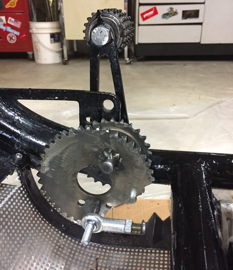

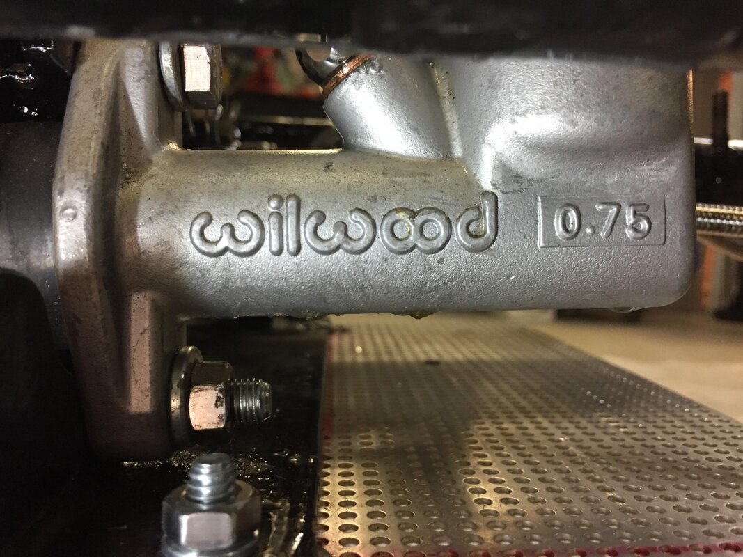

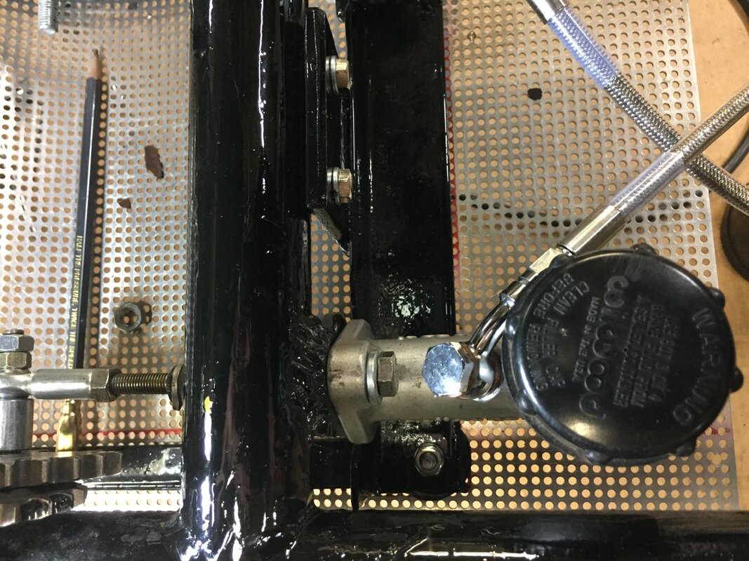

this is my first build, and when I got the M.C. for the clutch and brake, I made sure it was 3/4", and had a big cup. IMG_5987.jpgIMG_5988.JPGthis is what I have in it.
Larry has a very valid point.
I did just assumed you have your linkage and lever all sorted.
So do you?
Travel?
Full retract/ push rod slack?
Lever lengths?
Full retract/ push rod slack?[/QUOTE]
My pedals ( I built ) presses the M.C. all the way in, and lets it go back all the way... and I think are straight .
Nothing wrong with that brand or style of master.
Still by everything you say it still sounds like air. Things can be hard to bleed sometimes, especially if you are by yourself.
So what I said about the master..... when first time building mine I worked the pedal so much and the master was too dry. I wore out the seal cup. It would not seal up and make pressure.
Took the master apart and went to the local auto parts store and bought a 15 cent seal cup. Put it in and away I went.

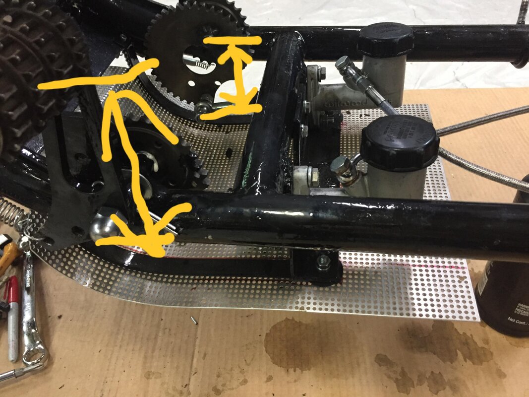

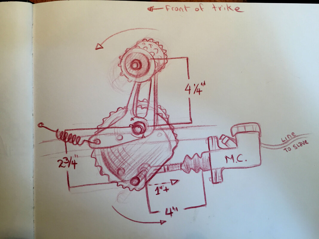

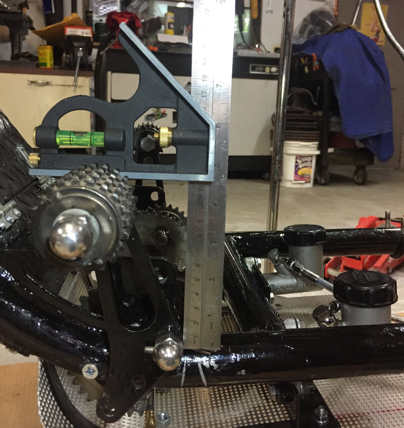

I push the pedal.
the slave cyl puls the throw arm until it touches the P.P fingers.
the pedal also stops moving.
if i adjust the slave, and take it all the way, till it hits the finger , the pedal and slave won't move.
no mater how i adjust the slave... it will always go to the same point( the fingers)

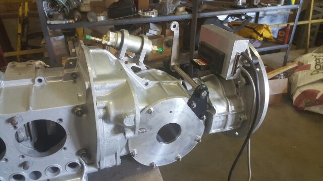

IMG_5990.JPGthe fIMG_5991.JPGirst pic is before pressing the pedal... if you can see the markings by the base of the throw arm .. the last dot is where it need to go, the dot before that, is where it touches the fingers ( all the slack out )
your mc looks to be exactly the one I am using....with 3/4 mc and 7/8 pull slave I have enough travel, but very little extra, not good to overtravel a pressure plate anyhow.
when you reach that point of contact , does the brake stop pedal rock hard, or does it slowly go to the floor?
I'm wondering if the mc is bypassing on the cup, or if the mc is jammed up inside ,or missassaembled?
I would take that mc apart and look....could even be wrong pushrod or piston length....then I would call willwood and ask them what parts and dimentions the parts should be. I'm sure they will be glad to help.....they have a reputation to protect.

If so then the mechanical ratio of your foot pedal is to low. Should be around 7 to 1.
If it is ......say 2 to 1....it will take a whole lotta pressure on the pedal to work.
If this is the correct list of symptoms then try pressing harder.

Let's work the numbers and see what we get.
1) which pressure plate do you have?
2) length of lever, hinge point to clevis?
3) length of lever, hinges point to foot pad?
4) we already have mc bore.
5) we already have slave bore.
6) and we have the stock throw out fork.
Stock beetle.
600lb plate
Stock throw out
Cable
7 to 1 pedal.
Equals 42 lbs of push on the pedal. Which is nothing for a leg to push.
So now let's guess yours out.
Super heavy duty "bus" pressure plate.
Stock throw out.
.857 ratio on hydraulic (.750/.875)
Foot side of pedal 6 inches.
Master cyl side of pedal 3 inches.
Equals 257 pounds of push on the pedal.
pedal ratio could very well be the problem, considering the seemingly normal hydraulic function.
use a temporary lever on the clutch pedal to get 7/1 and give it a try.
also, I would watch the strut for the slave that is standing out from the case, see if it deflects under load, if so it could contribute to lost motion.
