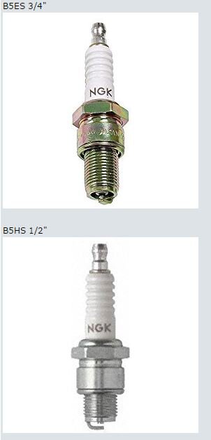

Stock, dual port, 1600cc with 34ict's, dvda distributor. What plugs are yall running? Which plugs and what reach? Just wondering.
Stock heads NGK B5HS (short threads)
Heads with longer threads NGK B5ES

Make a simple tool to measure the depth of the spark plug threads in the head. You just need a small stiff wire (paper clip) with the last 1/4" at one end bent at 90-deg. This is where we will measure from.
Bend a loop in the other end 1" in diameter (you are trying to bend the other end of the wire so it CANNOT fall through the spark plug hole... no matter what -- tie a string to it if you are worried)
The point to understand is that when the spark plug is the correct length, none of the threads will be exposed INSIDE the combustion chamber.
You insert the the small end of the tool and try to hook the inside surface of the combustion chamber (chamber edge of the spark plug threads). This is the bottom of the spark plug threads in the head.
Make a mark using a marker on the tool. A good spot is where the tool meets the spark plug hole in the head tin.
Now pull the tool out so the small bent end is lined up with the upper end of the threaded spark plug hole.
Make another mark on the tool where it meets the tin hole. Take your ruler and measure the difference in the two marks. This is the depth of the spark plug threaded hole.
Stock VW heads used 1/2" deep spark plug holes.
Newer heads use a long reach 3/4" deep plug hole.
Which is closer to the length of your two marks? That is the proper length spark plugs for your heads.
(got this from a post on another site)
Stock 1600 air cooled is a short reach plug. Short or long depends on head thickness, as the others have pointed out. There is no advantage to a long reach, and long plugs could get contacted by a piston or valve.
The easy way to determine length is to pull known good plug and measure it.

I measured the thread depth and I should be running the 3/4 reach plugs so I put in the bosch 7904. I believe they are a heat range 8. Think that
is what was in it when I got it. I guess it has aftermarket heads. Tried to call the guy I bought it from but couldn't get in touch with him to ask about the heads.Thanks for the suggestions.
