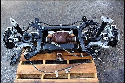

Or even an irs from a ford and super short drive shaft.

like that irs idea.....then pumpkin can be rigid mounted w/ short shaft..... the axles can be the suspension components. maybe easier said than done, but worth some thought......larry
Drop this out from under a mustang......and..

this irs business has got me wondering???........looking at an irs trike from the rear....when you hit a bump or pot hole with one wheel wouldn't the up/dn travel of the wheel cause it to "arc" or pull in toward the center of the trike, causing the rear of the trike to pull sideways? the shorter the axle the more inward pull? maybe the ridged axle is more stable? what say you guys? larry
This is a long debated design theory.
Straight and IRS is available on several of the bought motorcycle conversions.
Might be interesting to go over in the wing and harley sections and search/ask.
