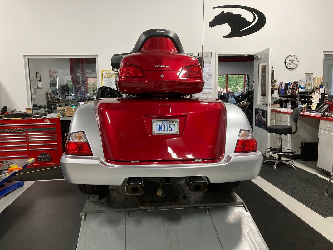

I have a Roadsmith kit on my 2012 Wing. I do not have the Accuride option, but I do still have the adjustable rear preset. The dealer set it at 15. I tried it at 20, and my wife likes the way it absorbs bumps better. It looks like the preset goes up to 25. What are you running?
Road smith just dropped off my bike, I checked it and it was set at zero. I need to play around with the settings and see what differences I notice. I ride alone
