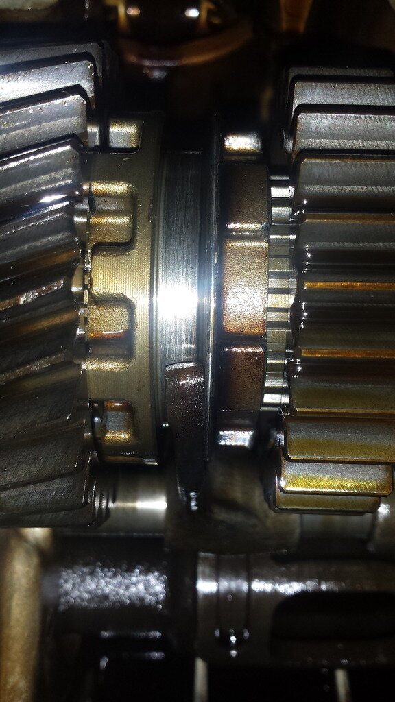

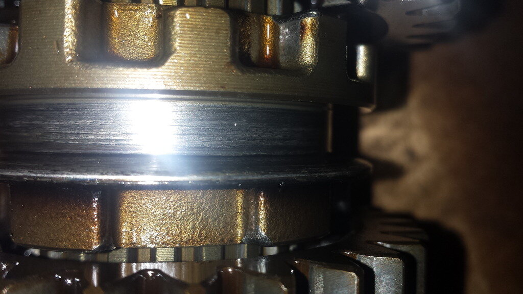

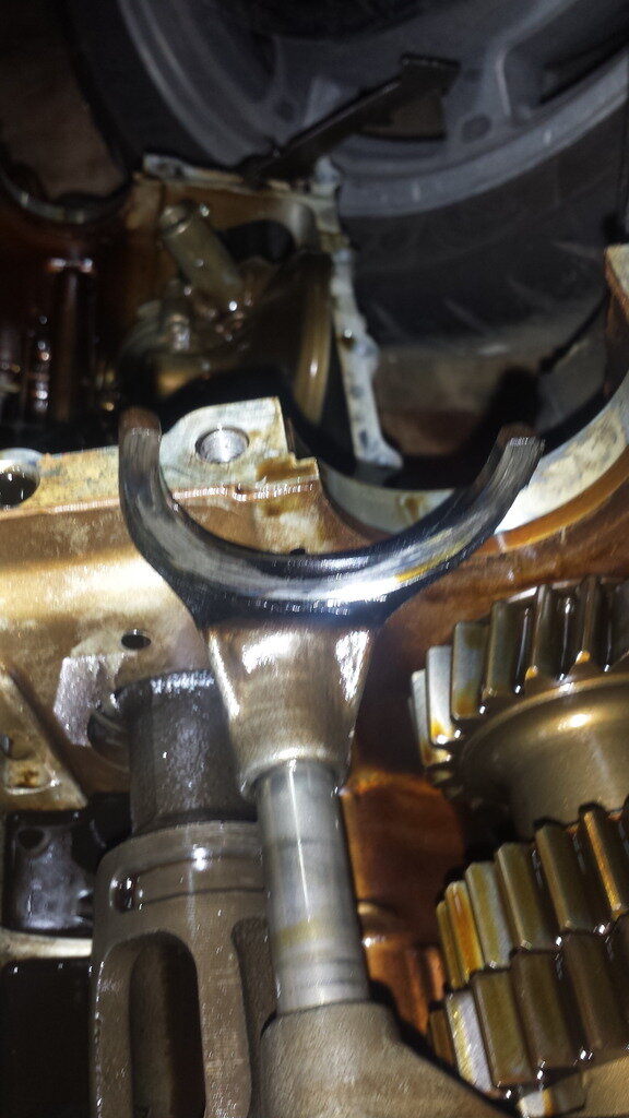

Got bored and dissected it today.Suspicions confirmed.Damaged fork and collar.
I remember you saying that.I noticed last year that my shifter was sticking part of the time basically mimicking riding with heel on the shifter.My fault I realize but I did change lube and haven't had a reoccurance but I realize that may have caused this.Any advise is welcome.
20170411_192934_zpsdmex1l1t.jpg 20170411_192851_zpsiihxx3f1.jpg 20170411_192803_zpshzzgbdgs.jpg
After I snapped the last pic I noticed the shaft wasn't seated completely so the fork may look much worse than it really is.
In the circle, is that a broken tooth ???
The gap, is worn wide, and the fork is worn thin. It means that the fork cannot place and hold the slider gear that the fork rides in, in a correct position between the gears. Thus your chatter. Because of the wear, it also means that when the slider gear is pushed into a gear for engagement, that it's not pushed in far enough for a healthy gear change. The blueing on the fork and the slider, is from heat.
