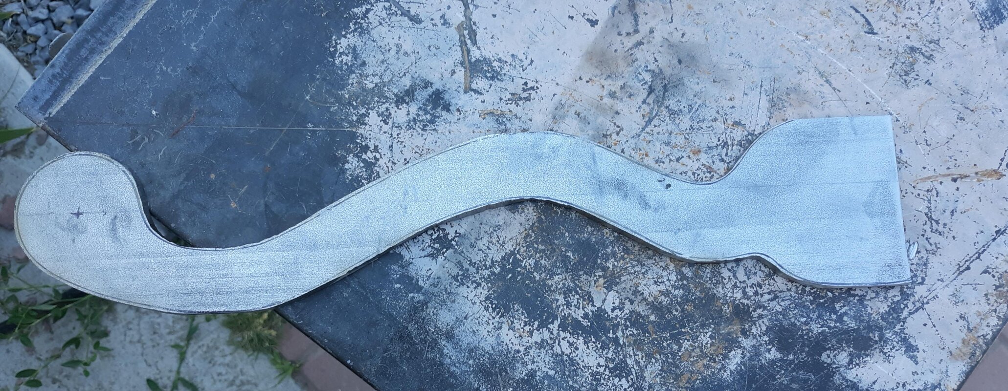

I roughed in with a 3m pad on a grinder.
Here is a part with a portion roughed in.
After this it was all wet standing down to 1000 grit.
Then the buffing wheel and compound for large parts and hand rag and mothers for smaller parts.

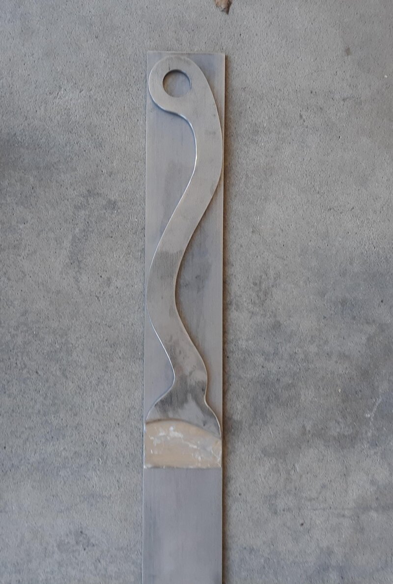

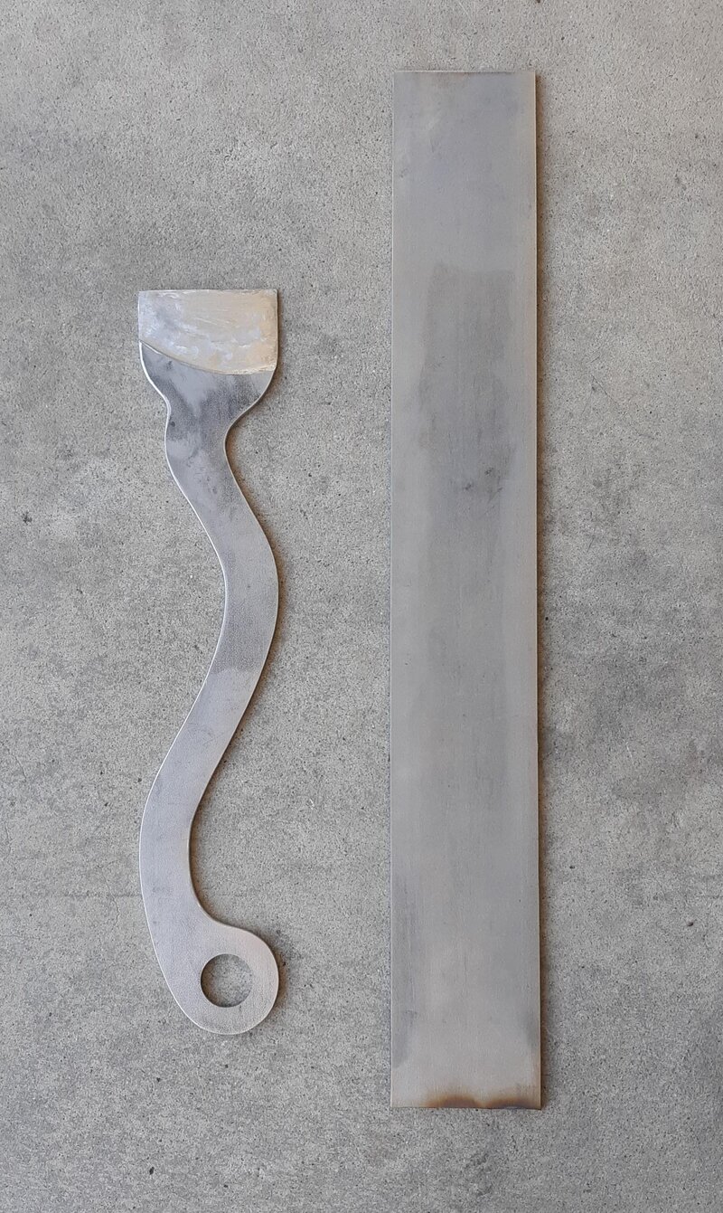

A bit of an update on how it is all going.
I was able to get my rockers cut out via waterjet, the cost for the pair was 60.00-----shop cost of course.
The brake stay is completed, well except I have a few new pit marks from the shop work that I will have to work out so all can be polished up (I just hope I can get them out)
