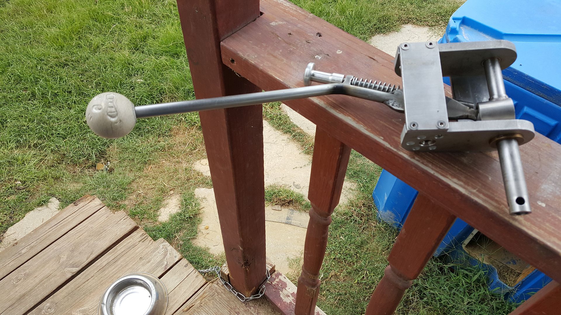

If you are feeling creative and want something specifically yours.
Make your own.
