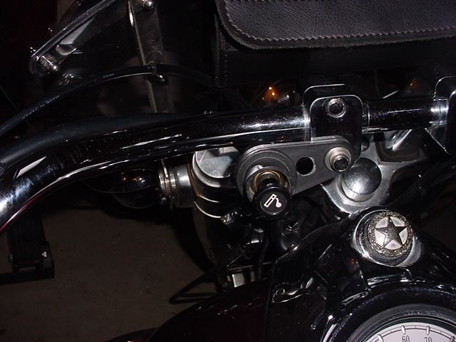

On my 99 Valk which had no pod. I added a marine grade supposedly water proof lighter off of Ebay to the risers.
1 bolt and let it sort of hang over on the left side.
Same thing on my Road Star.
