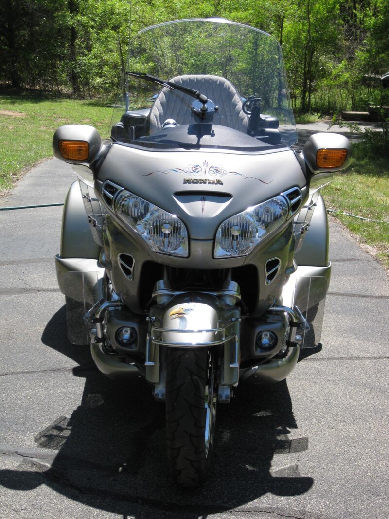

Honda Goldwings just have crappy front fork technology and the Valkarie uses the same cartridges and on my 2003 that was a bike I just never felt like they were made for the chassie of the Goldwing.. so in 2004 I sent my forks off to traxxion and had them work their magic and install the AK20 Cartridges and while they were gone I also bought a true Super Brace fork brace so when the forks arrived I reinstalled the works and changed riding for the better ever sense then. No more harsh riding front end, no more wholoing in turns or washed out feeling, removes the harsh bumps and makes them caddy smooth.... really !!! Ask my sleeping other half on the back of the now Roadsmith 2012 Triked 2003 GW, she sleep on the bike to as she just put her hands in my jacket pockets and leaned on my back until I could bounce her helmet off mine enough to wake her up...
You will really notice the difference in front tires as the cupping went away and mileage went up... now even better as a trike with Bais MPA up front.... sorry pictures aren't better but I usually don't take a photo of the front fender area... Best I got.....
